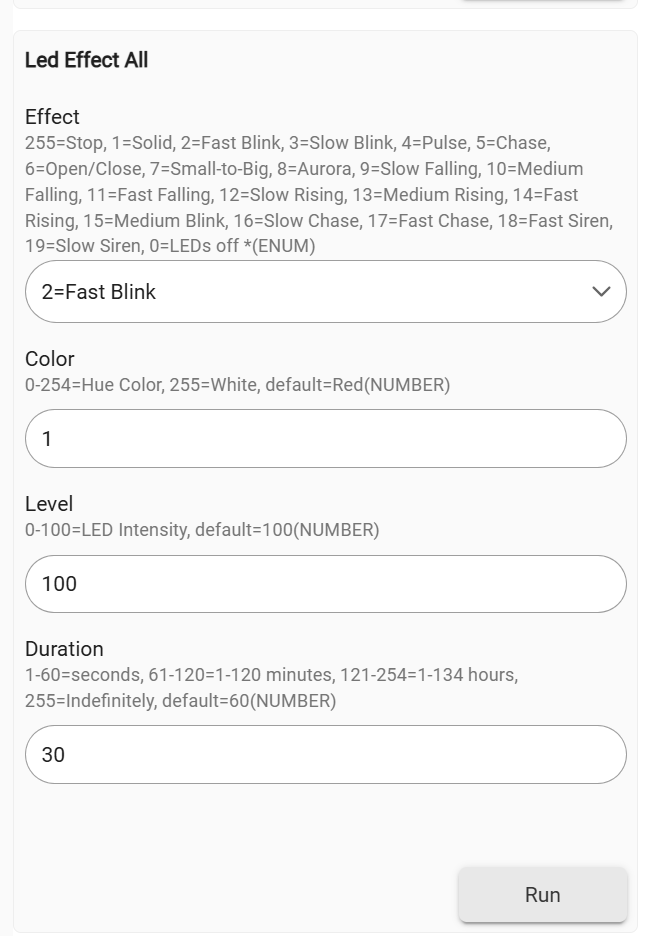

It (being the entire switch) does not respond to any notification commands, regardless of what led, animation or color I select for notification.
Let me know how the factory reset goes. So if you do this for the device you don’t get a notification:?
Edit: are there any errors in the logs?
Yes, doing this did not give me a notification
