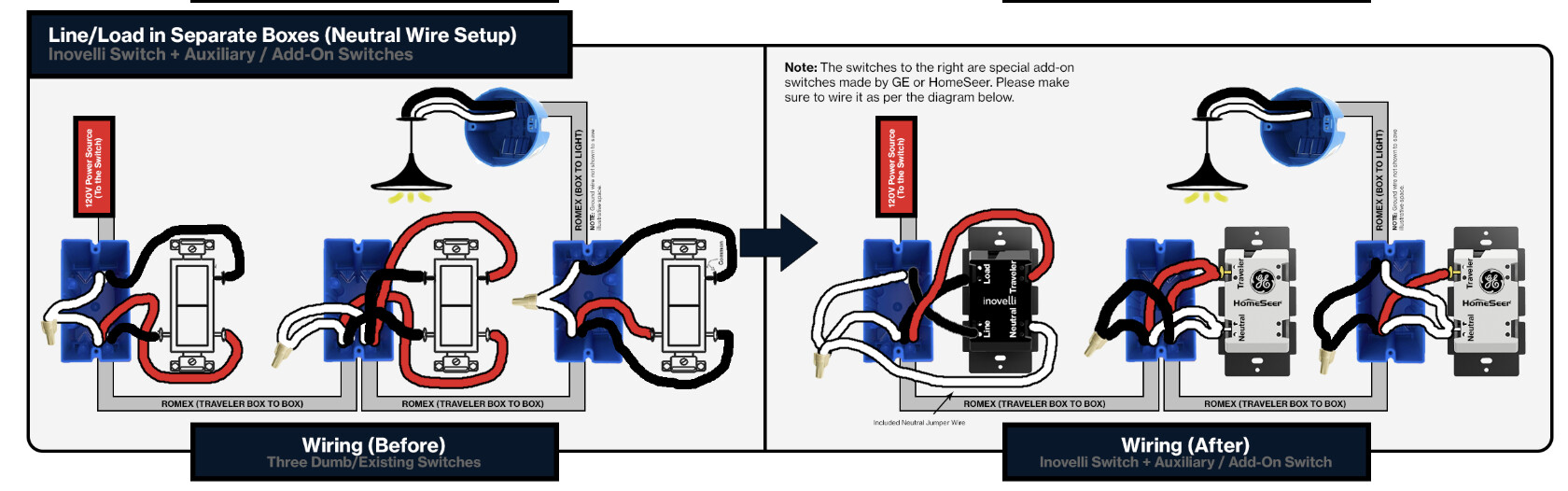

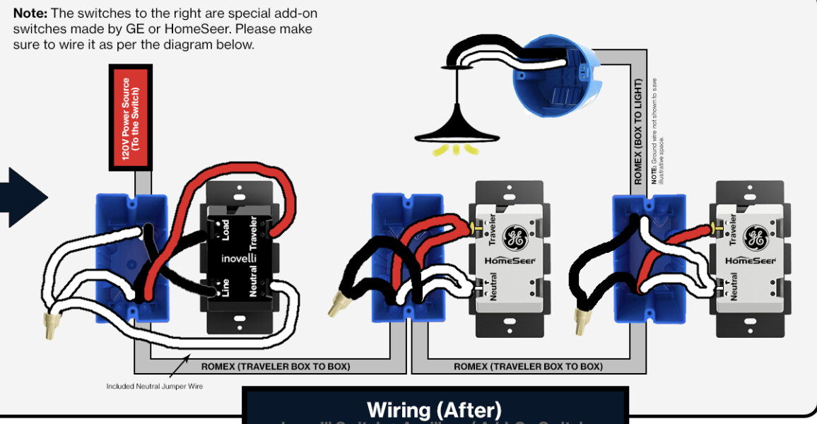

Hi this is my first post :). The context is… I have a 4-way light setup currently and I want to use one Inovelli dimmer and 2x auxes to replace them (with neutral). The diagram on the left matches exactly what I have right now
However the line box is too close to the entrance and I rarely use that switch, so I’d like to use the Inovelli on the load side switch box (the rightest in the image), with the rest two as aux switches. In my understanding Inovelli can do it as the smart switch can control the aux to provide power all the time, but I… I just want to make sure how to do with it before proceeding…

Yep you can do that. You’ll put the Dimmer in the Load box and Auxs in the other two.

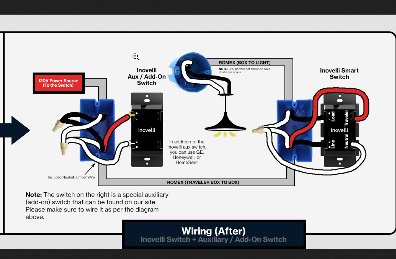

There isn’t a published drawing for the 4-way in this configuration, but there is one for a 3-way. The concept is the same. You’re just adding another Aux in the mix.
Here is that drawing. Post back if you need more details.
Thank you! yeah I think I know what to do – the middle 4-way dumb switch should be replaced like the middle one in this picture I guess
will try out tomorrow!
Exactly!
