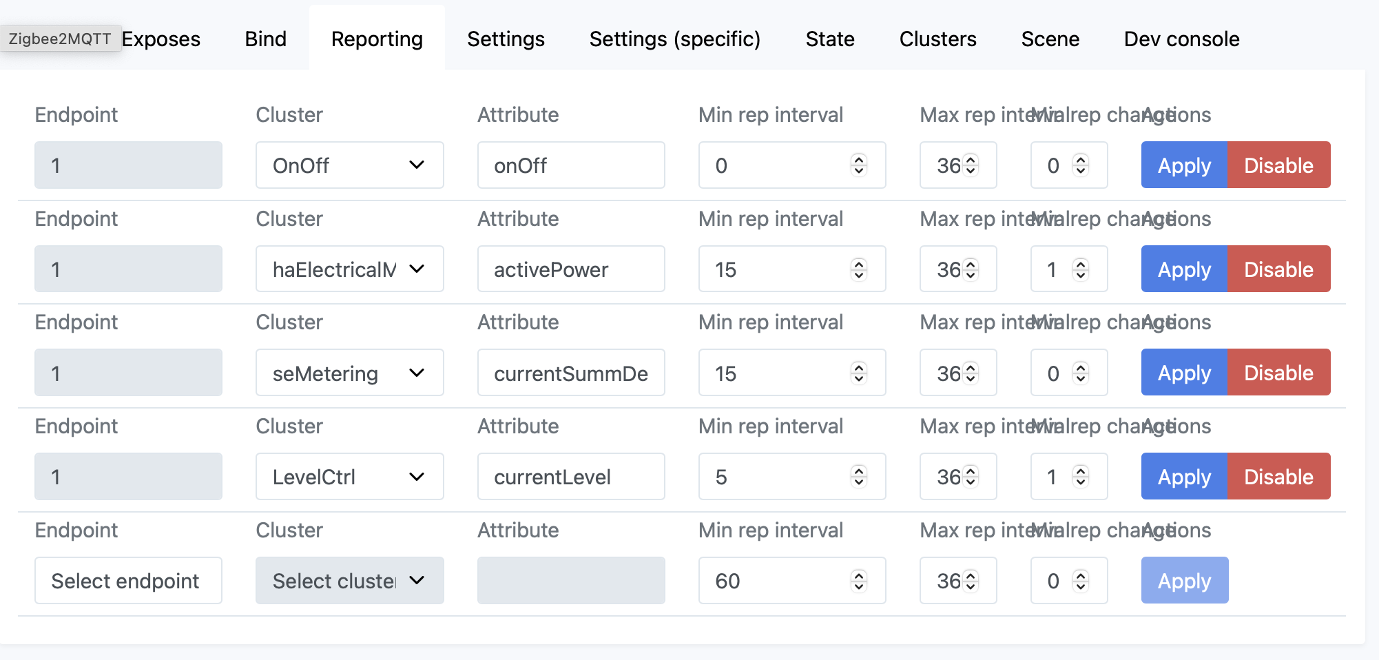

Just noticed the Reporting section. Doesn’t seem to have a lot of details, and it looks like its on a per-entity basis, but is there something there at needs to be setup for the Inovelli cluster?
Nope, the reporting section should be fine. It’s setup automatically when the device is first configured.
Hmm, if it should have set something up then maybe that’s the problem then. This is a new install with z2m 2.0.0, where all the devices have been paired using 2.0.0. Here’s a screenshot of the Reporting section for one of the devices. Only a few items in.
That is setup correctly.
