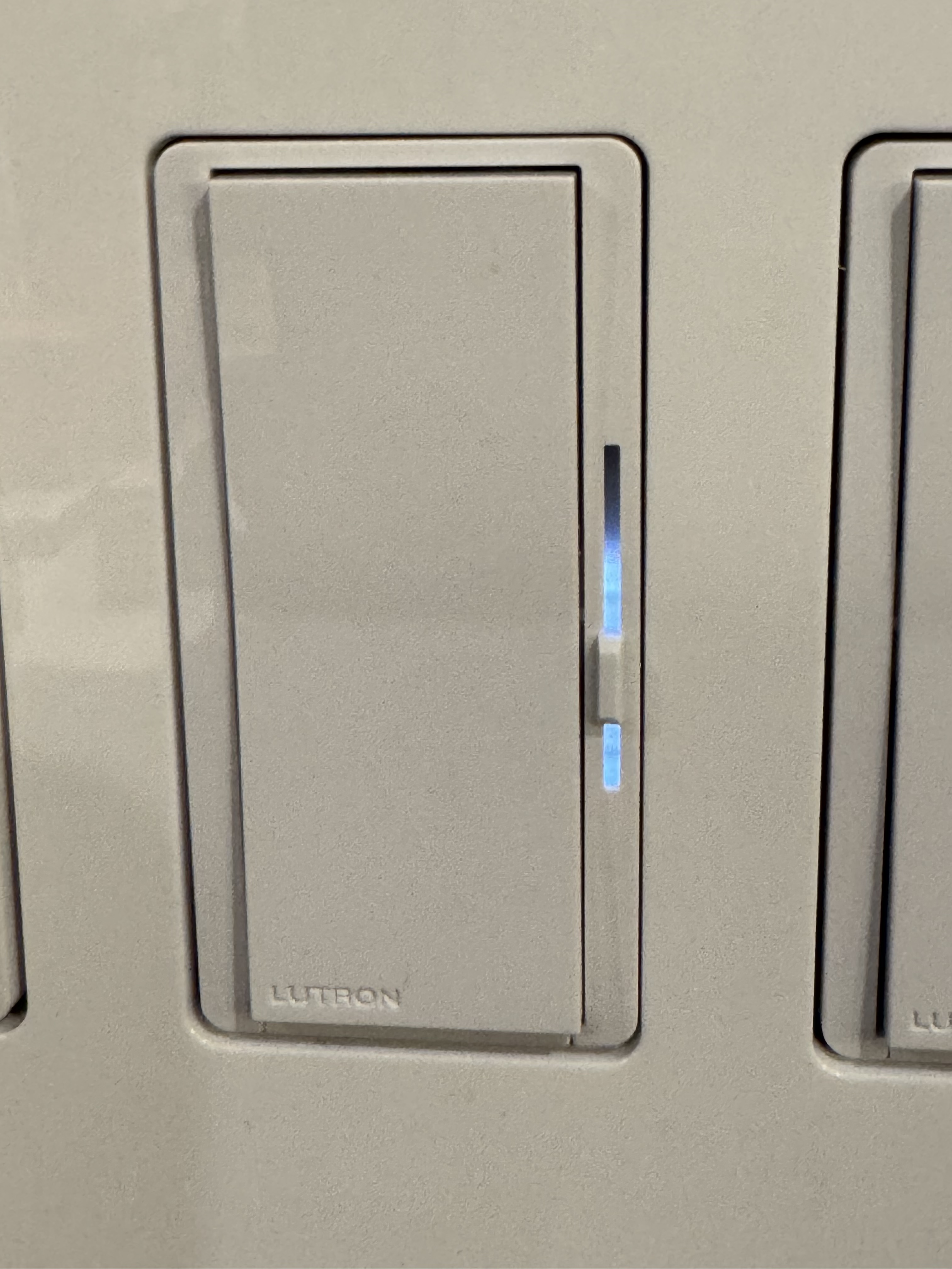

Would love to know if inovelli ever plans to release a dimmer with a direct physical dimming mechanism rather than “push and hold” (like a capacitive sensor over the LED, or a physical slider like the lutron diva switches), that we can look out for some time in the future!
So what happens when the hub changes the dim level and the physical slider is no longer matching the level. Say for example the slider is all the way up but the actual dim level is minimum how can the slider be moved up to increase the brightness?
The way lutron handles it is any motion on the physical slider immediately overrides whatever the hub had the level set to.
So if hub set the light to 25%, but physical slider is maxed, just lightly nudging it down sets the light to 99% or whatever and you can max it to 100 if you want.

@scott-gardner This is how lutron handles the discrepancy. Any motion of the physical slider immediately sets the LED to the position the slider is at.
