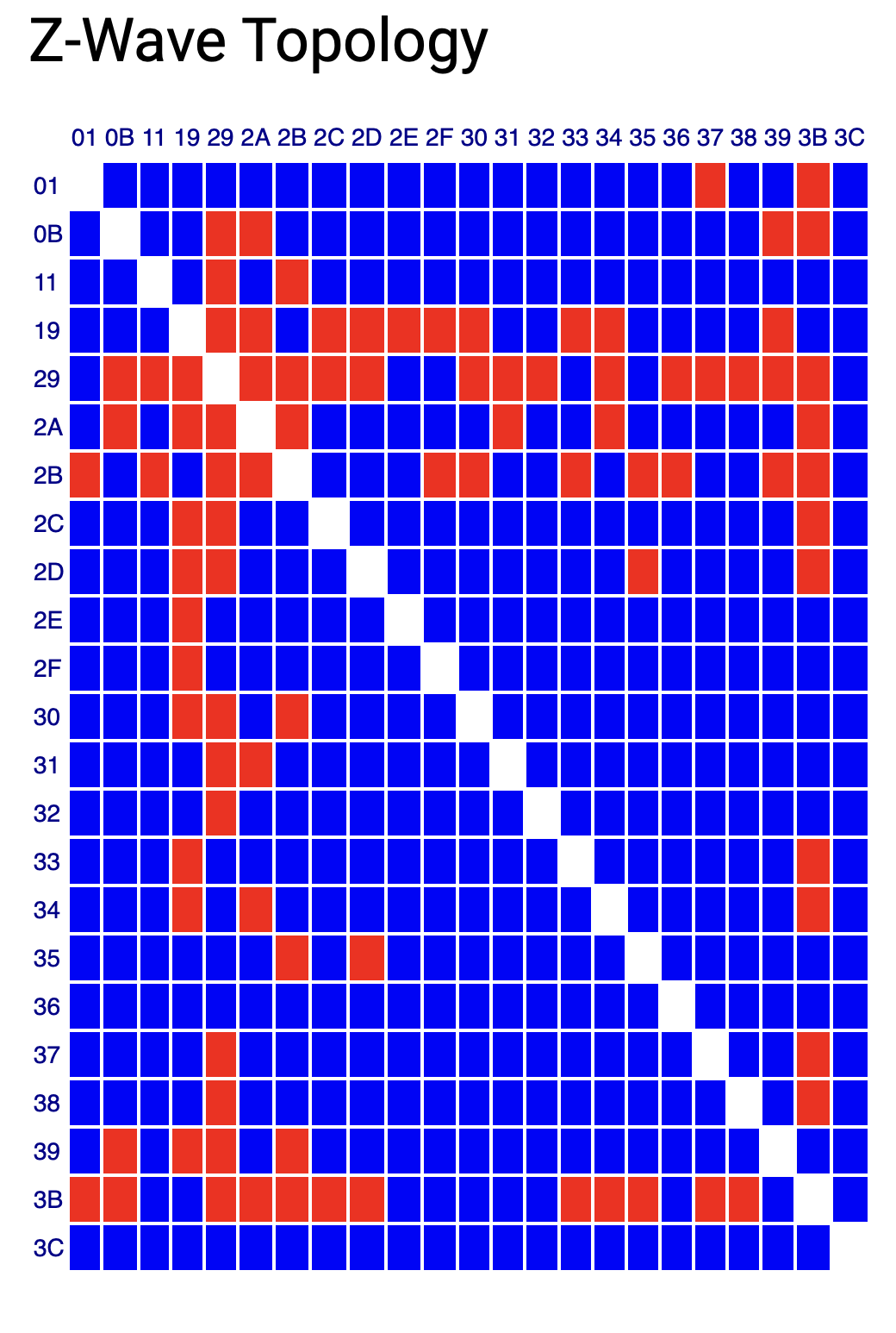

I’ve been using the Inovelli Red Series dimmers for the last month along with my Zooz switches and Hubitat. I must say I’ve been pretty disappointed with the Inovelli switches. I had high hopes as most people rave about these switches. I do a signal test and I get a green bar which is great, but get awful results with double and triple taps for lights within 20 feet. Below is what I see in Hubitat. I’ll let you guess which switches are the Inovelli switches. I even moved my Hub within 3 feet of one of them and excluded and re-included a device with no change.
It’s been awhile since I’ve played minesweeper, but I think you got one.

What’s odd is that I have a switch 2 feet from the Hub and looking at the route it actually jumps to the Inovelli light strips in the basement and then back to the Hub rather than going straight to the Hub.

Interesting thing happened…About 2 weeks ago after I started this thread I turned off S2 and redid all the devices. No change. Last night, I updated the firmware on my Inovelli switches to the latest beta version. What happened makes absolutely no sense, but now the Inovelli devices have a lot more neighbors! Guess they moved out of the country and into the burbs.
