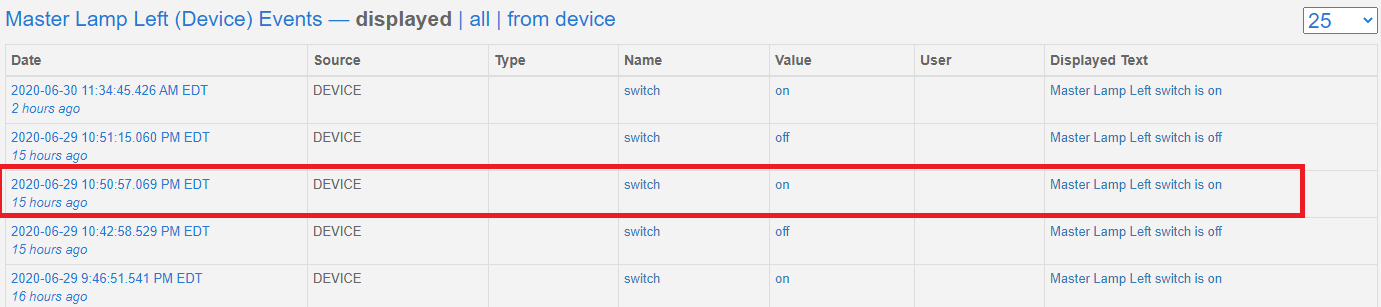

The master lamp is a cree lightbulb. Note the time on. Not me…it’s the ghost…(breaker coming back on I assume…)
CORRECTION. The light coming on its own is at 11:34 AM (not the 10:56 PM…sorry)
