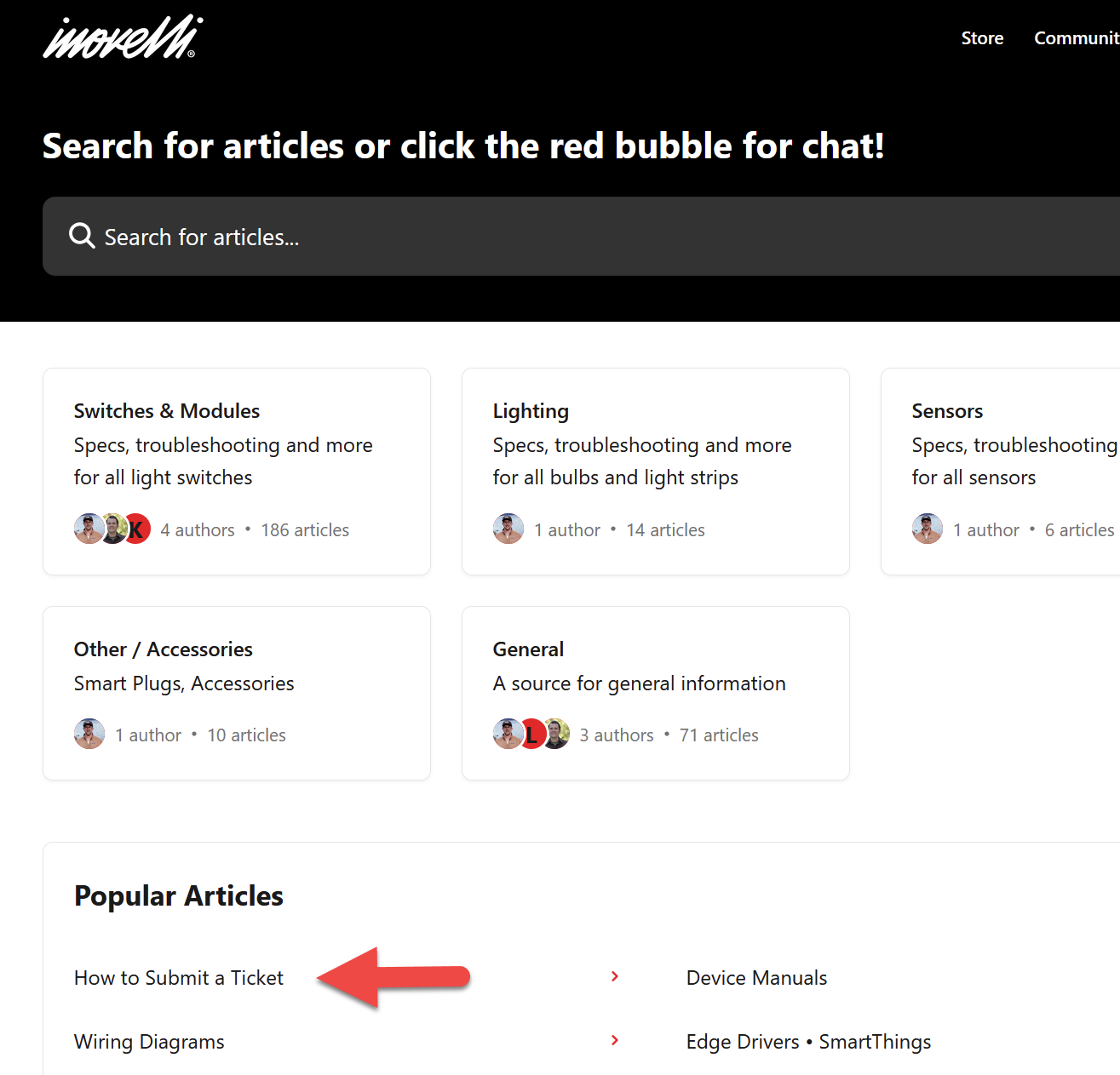

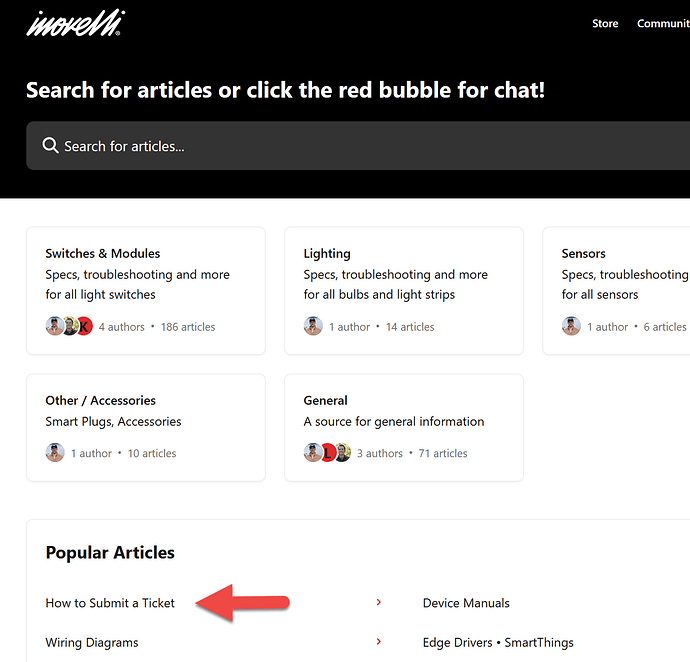

If you go to Inovelli’s help site, https://help.inovelli.com, the link for “How to submit a ticket” is on the main page. That link will take you to How to Submit a Ticket | Inovelli Help Center, where you can either start with IRA, the bot, or use the e-mail address listed for support, [email protected] .
Thank you! I don’t know how I missed that. I will send them an e-mail or open a ticket.
