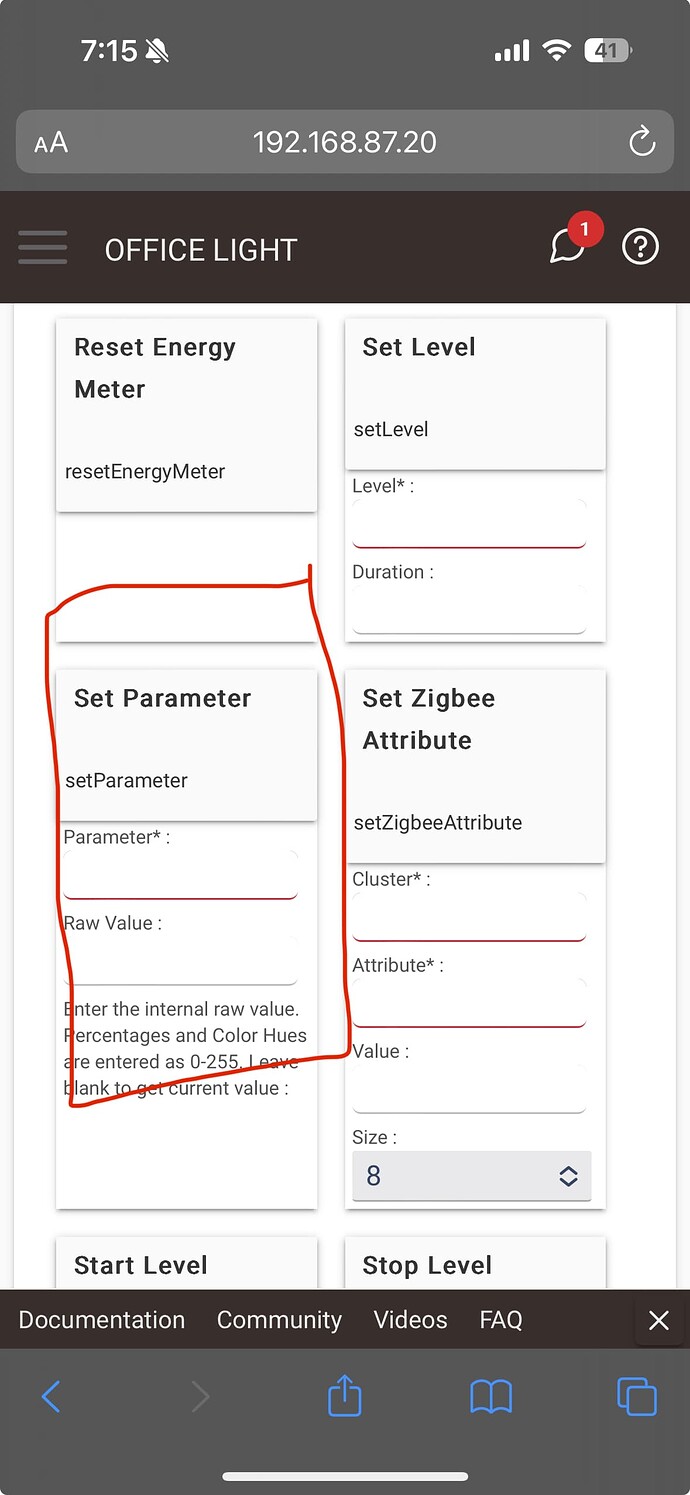

Using Hubitat, where do I locate that parameter?
I do not see it listed under the device/ state variables?
Am I looking in the wrong spot?
You do it from the switch - instructions are in this article.

Looks like its parameter 26. You should be able to send it from within the device parameter.
having trouble getting it to respond manually. Looking up the switch I have it is a LZW31-SN the parameter listed for this switch does not list 26. Is my switch just not capable?
