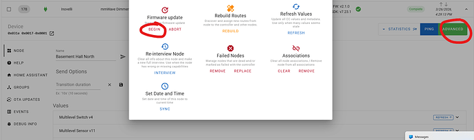

How do I install this firmware? I’m using home assistant, I don’t have a hubitat device.
In the Z-wave JS GUI you click on advanced for the device and then begin firmware update. It will ask you which file and you use the one you can download in the top post:
Hm, I’ve never used the JS GUI, I just installed it and it looks like I need to enter some security keys before it will show any devices. Not quite clear where how to find those or where to enter them.
Honestly, I am not sure. I assumed since you had Home Assistant setup that Zwave JS was already running in the background (and you just needed to open the webui). Can you explain more about your configuration? If you want to PM me with screenshots you are welcome to do that as well.
