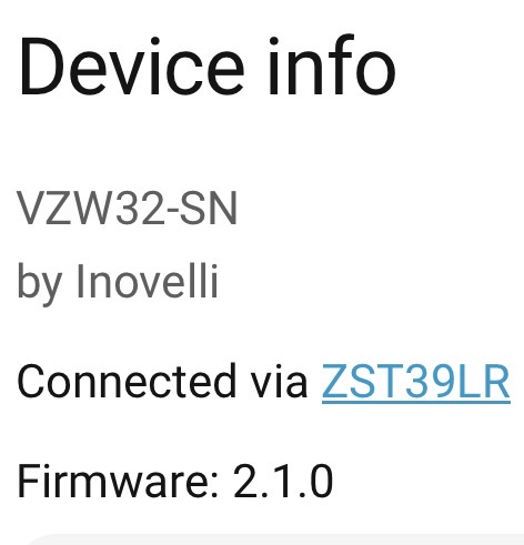

Typo in version. Registers as 2.1.0, not 2.01

Can confirm the firmware shows as 2.1.0. I was not experiencing any issue with the switch prior only been installed one day and is not used often.
