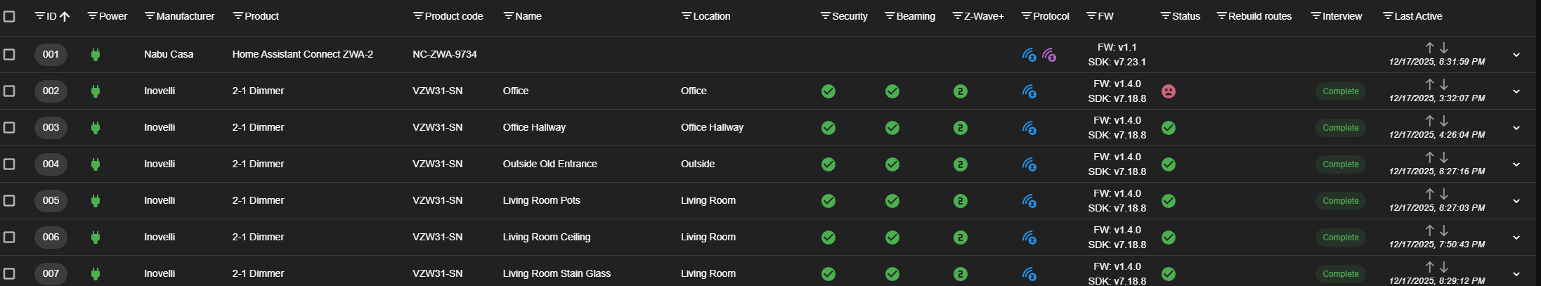

Here is what it looks like when it occurs in zwave js UI. It just shows “Dead”. Then if I go just press a button on the inovelli switch, it starts responding to ping in zwave JS ui. It definitely seems like a inovelli bug because I don’t have issues with other zwave devices disconnecting ever.

Then after I press the switch it comes back online with this:
2025-12-17 20:36:14.569 INFO Z-WAVE: [Node 002] Has returned from the dead
