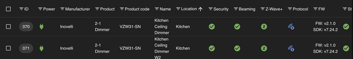

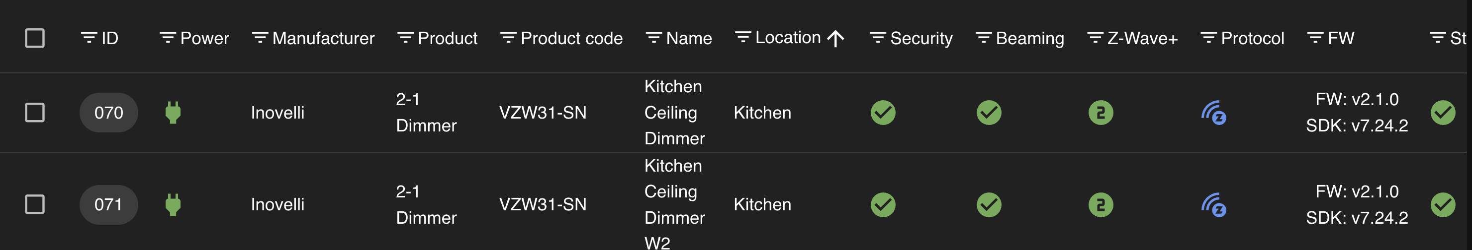

Hi Eric,I recently updated my devices to FW: v2.1.0 SDK: v7.24.2 using the file from the Red-Series/Z-Wave/VZW31-SN-2-1-Switch/Beta/2.01/ directory.
Since the update, I have been unable to group my 3-way dimmers. I attempted to roll back to FW: v1.04, but the downgrade failed with an “Invalid firmware target” error.
Could you please advise on how I can successfully roll back the firmware or, alternatively, how to make FW: v2.1.0 work with a 3-way configuration?

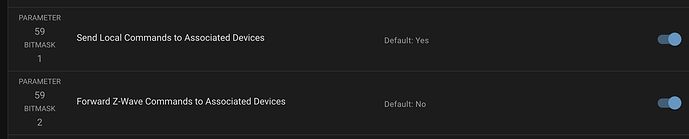

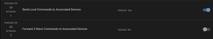

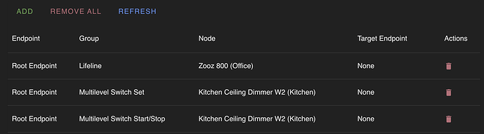

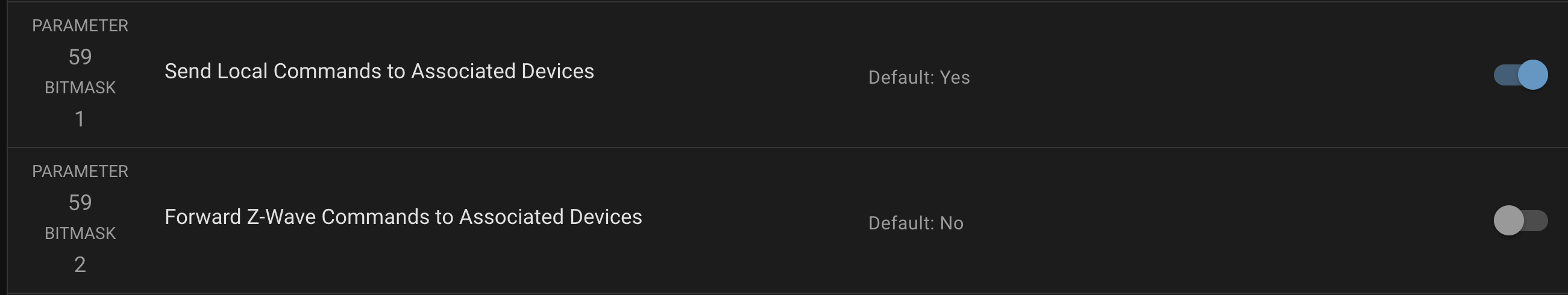

It is possible that you will need to delete your current associations and recreate them. So
Switch A > Switch B Group 3 & 4 (Maybe 2 depending on use but I always just do 3 & 4)
Switch B > Switch A Group 3 & 4
Change Parameter 59 to 3 on only one of the switches (the master).

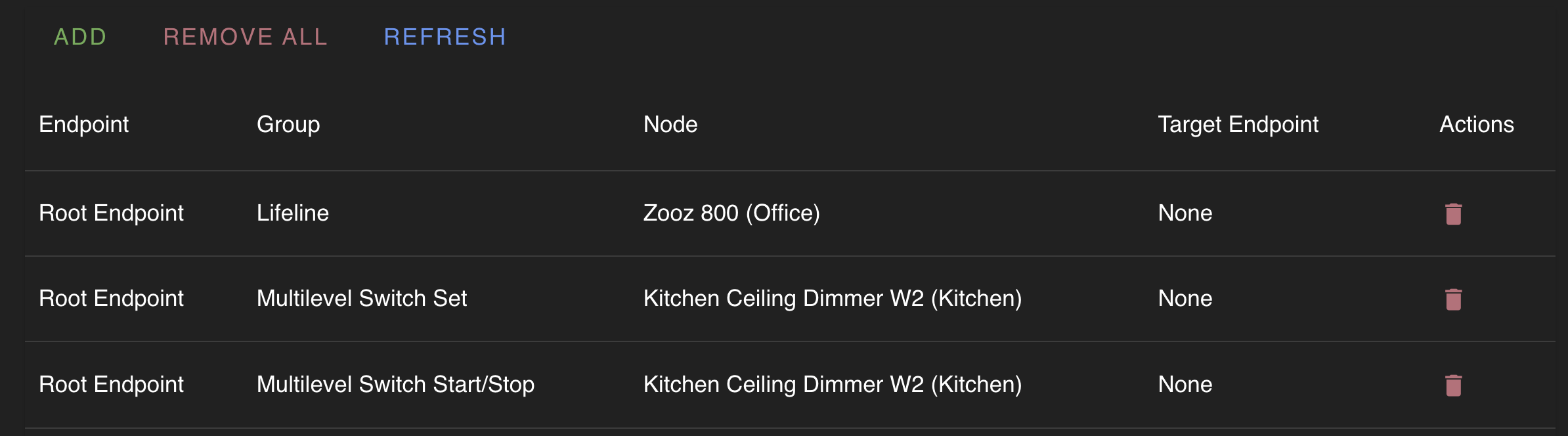

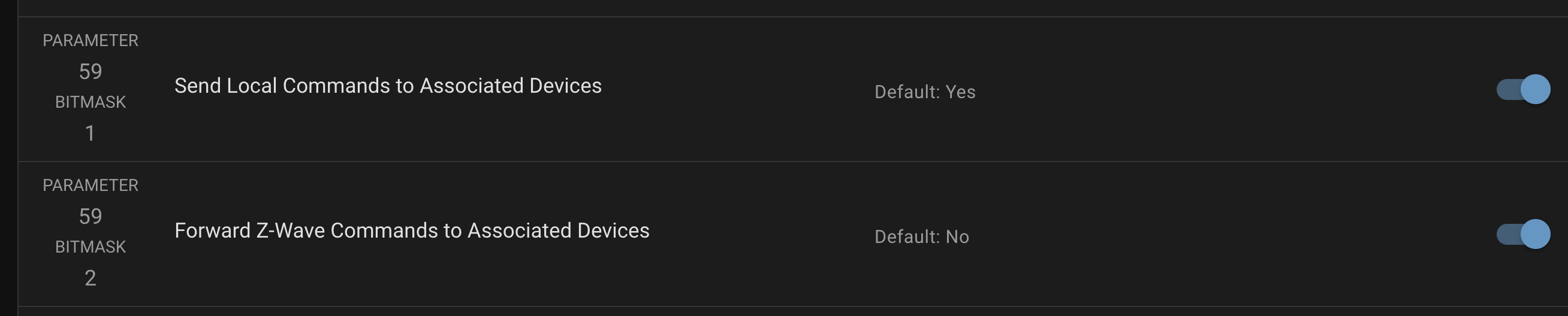

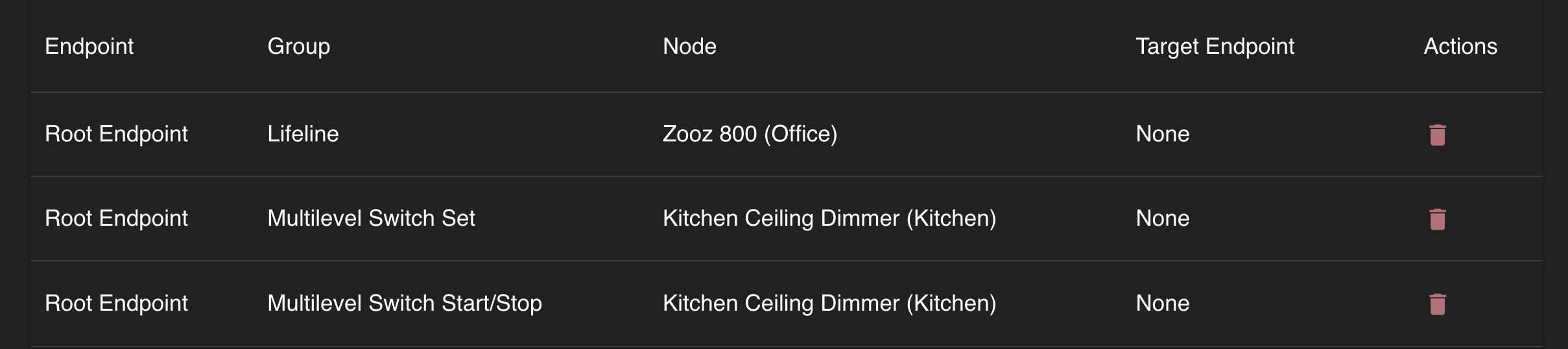

Hi Eric
This is what I repeated several times.
Associations looks like that
Kitchen Ceiling Dimmer:
Kitchen Ceiling Dimmer W2:
I have many 3-ways and 4-ways configuration in my Z-wave network. Never was a problem.
The only difference is FW version: v2.1.0 vs v1.02
The associations on those two specific devices worked just fine before I moved to v2.1.0
Regards
Vladi
That looks right. I will have to test it out, but the switch may require a factory reset if you haven’t already tried that. There is an SDK update so lots of “cobwebs” might still be intact. I tested vzw31 ↔ vzw32 and didn’t have any problems so I would think that vzw31 ↔ would work . . .
What security level is each device? S2, S0, or non-secure?
Also, after you have the security level confirmed and the associations are looking good like above, can you pull the air gap on each switch to reboot it. Then wait a little bit and retest it?
@vladimir.korobov any luck checking the security level or with rebooting the switches with the airgap?
@EricM_Inovelli
Hi Eric,
Sorry for the delayed response—I’ve been traveling quite a bit lately.
I checked the security level, and it is S2. After rebooting the switches with the airgap and waiting for a while, everything worked perfectly! I’m certain I pulled the airgap before, but perhaps I only did it on one switch or didn’t wait long enough.
Thank you for the helpful tip.
Regards,
Vladi
