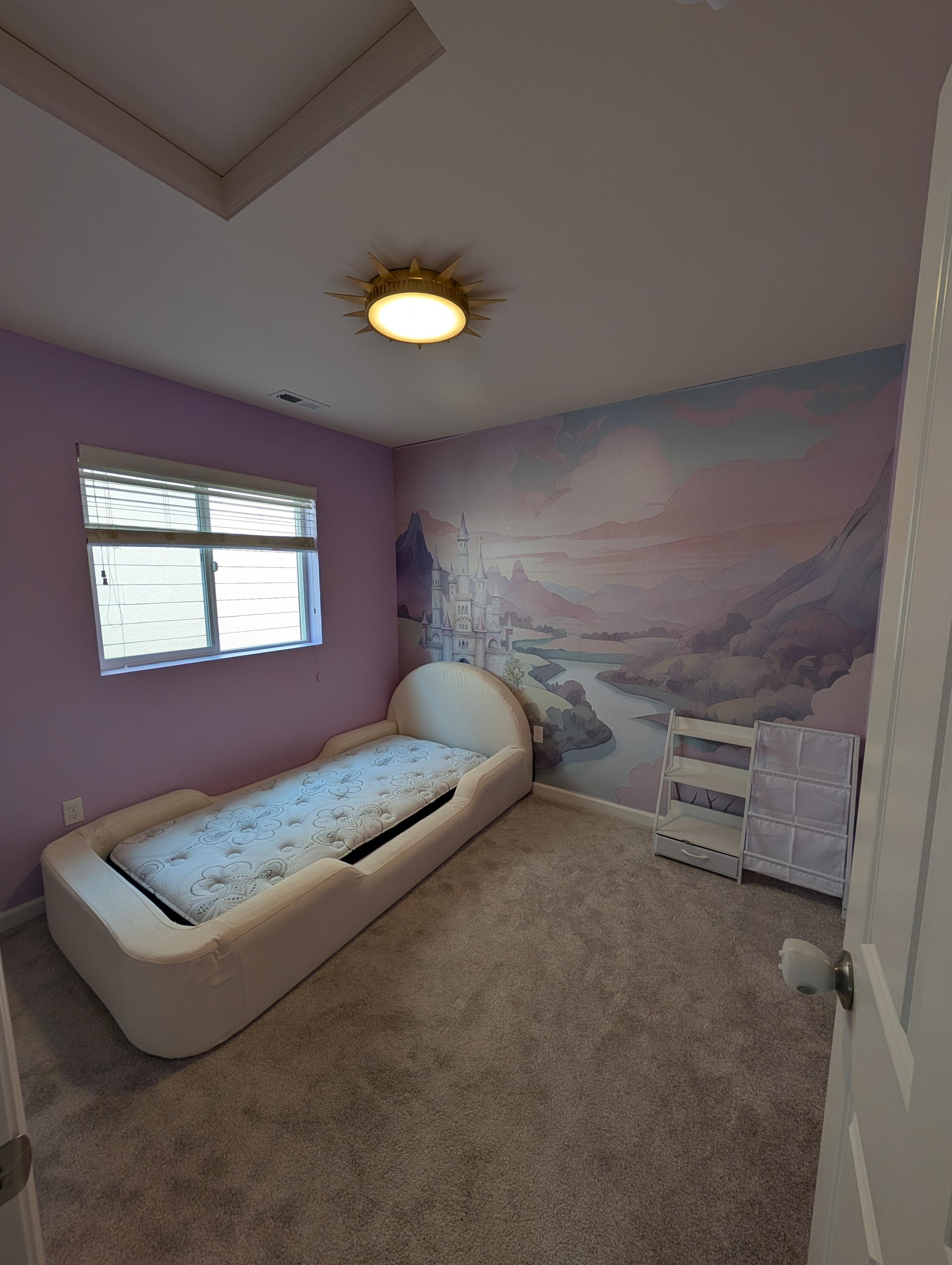

Quick update! I did manage to return the fixtures and get new light only ones. The box is 1000% not ceiling fan rated so it was a good call to abandon that.
Happily wired up my dimmer today (was a real pain to fit in the box, had to trim the existing wiring a smidge) and very unhappily wired up a replacement fixture that absolutely sucked to wire but looks quite nice lol
