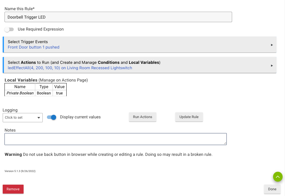

Here is how I just set this up for my Nest Doorbell and Inovelli Blue switch
For setting the parameters, I had to add a single number parameter (e.g. 4) four separate times (so, add param, number, 4; add param, number, 200; add param, number, 100; add param, number, 10)
This makes my switch LED pulse purple at 100 brightness for 10 seconds when my doorbell is rung. Pretty cool!
