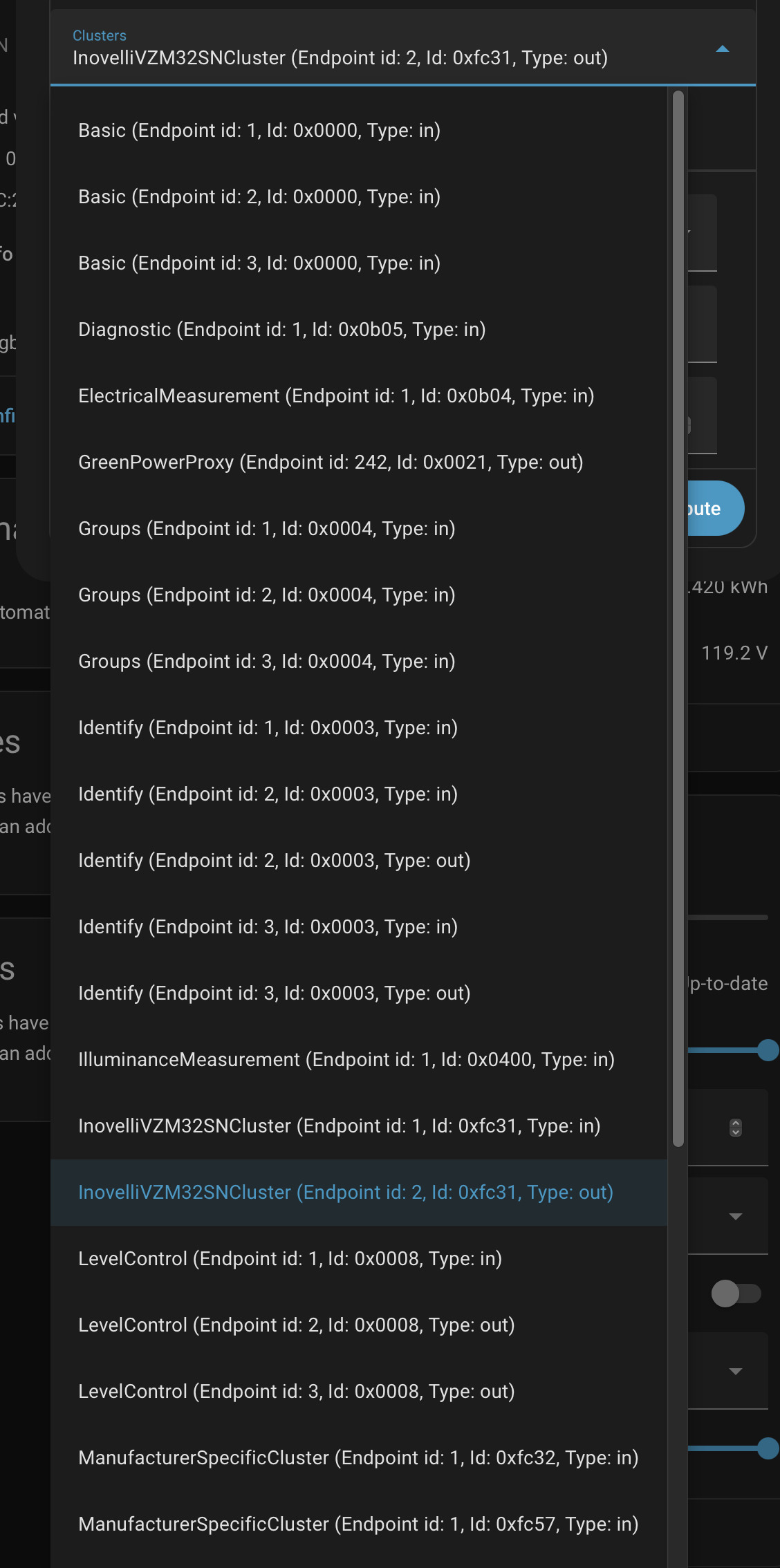

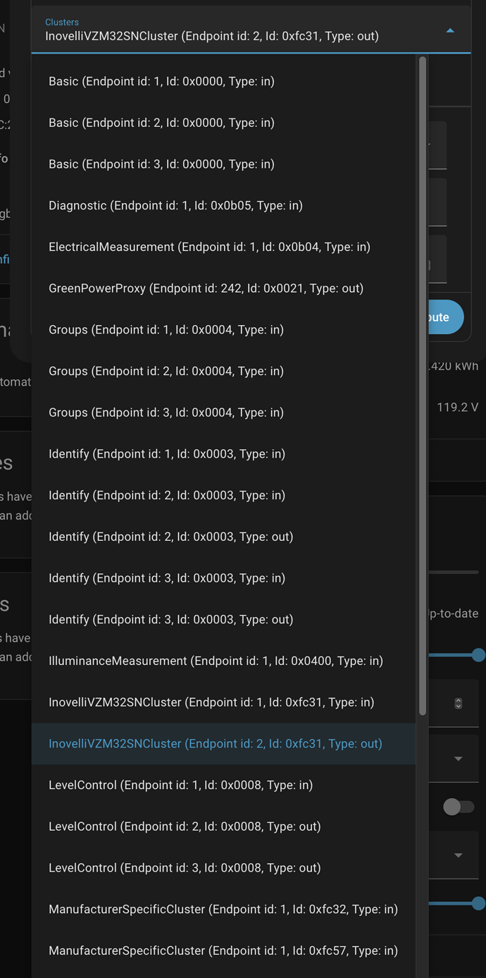

sorry for all the noob questions.. but where do I set the configuration parameter above? I have home assistant and don’t have a smart home hub. I’m looking at the ZHA interface for managing the parameters and which endpoint do I use to send that value? (screenshot below)
I don’t see parameter 110 in any of these endpoints. And do I have to put the switch into configuration mode before sending values from this interface?
I’m the last guy you want to get HA guidance from, but I think that at the present, you may need a custom quirk to expose all of the mmWave parameters in ZHA.
The parameter you’re looking for is in the InovelliVZM32SNCluster (Endpoint id: 1). It’s called light_on_presence_behavior. I do exactly what @hydro311 described. I have the parameter set to 0 and then use an automation in Home Assistant to turn on the switch when the mmWave sensor entity detects occupancy.

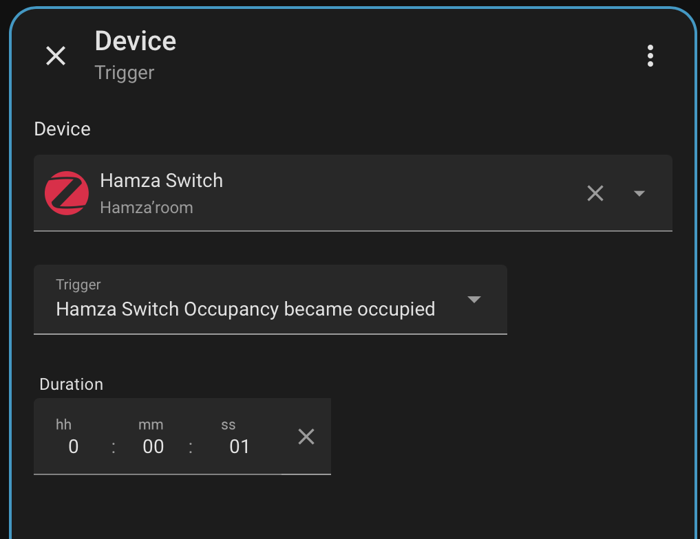

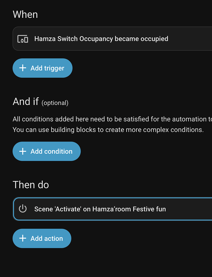

If I could bother you for one more question if that is ok now that I’ve been able to modify the above parameter. I’m having a little difficulty on one of the automation steps. If I use the inbuilt blue print for presence sensor for turning on light, everything works peachy. but I can’t edit it for scheduling.
If I create a new automation from scratch, I can put in scheduling time and all, however the following triggers don;t seem to activate the light the way it would with the blueprint →
The timing parameters shouldn’t impact your automation. I typically use a state trigger followed by light.turn_on, but the way you have it should work too. I’d look at your occupancy entity and ensure it’s showing detected/clear properly. If so, then the issue may be with the scene.
