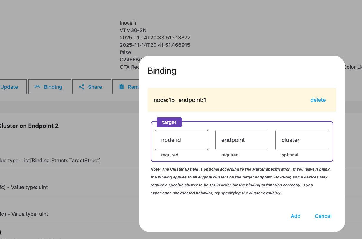

I recently installed White Series Fan Canopy VTM36 (1.0.0 firmware) with a White Series Dimmer VTM31-SN (1.0.5 firmware). Since Home Assistant now supports Matter bindings, I installed Matter Binding Helper (GitHub - cedricziel/ha-matter-binding-helper: A binding helper for matter) and set up the bindings between the Dimmer and Canopy. Here’s my binding setup:
(I called my dimmer “Switch” for this room.)
The dimmer is in Dimmer+Single mode with Smart Bulb Enable mode. It is wired as per the diagram “Single Pole (W/Neutral Wire) Canopy Module Installation With An Inovelli Smart Switch” (power at switch) in the wiring docs.
As shown above, I have the paddles bound to the light endpoints on the canopy (I want to use the dimmer as I would a good-old dumb dimmer). It works as expected to power on/of and dim the lights, except…

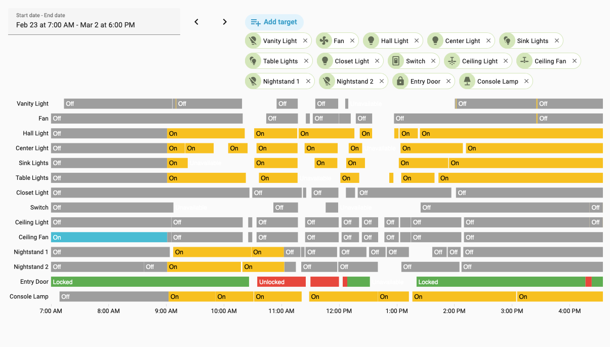

What I noticed is that I have a couple of early edition Nanoleaf Thread bulbs and their connections are really flaky. I had one finally completely die yesterday but had not removed it from Apple Home until today (it was never in Home Assistant). When Apple Home tried to run my morning automation, it partially failed (the automation turns on the failed bulb). Later this morning I noticed that one of my Home Assistant automations triggered by another Inovelli dimmer was failing. That prompted me to consider a Thread network problem. So I looked at all my Matter devices’ history in Home Assistant.
I saw a few drops randomly yesterday and overnight after the Nanoleaf bulb failed, but nothing major. But after the morning Apple Home automation ran at 9:00 AM, there was a storm of devices dropping, and not just Inovelli devices.
As soon as I removed the offending Nanoleaf from Apple Home, all devices have stayed online (except the other early Nanoleaf in the entry console lamp). More importantly, the binding between my Inovelli Dimmer and Fan Canopy is working as expected this afternoon. I think these two Nanoleaf bulbs have been destabilizing my Thread network, which would explain random flakiness I’ve been experiencing for a while, especially with my door lock.

Ok, it’s been almost a week, and except at times when my Thread network is unstable, the binding seems to be working normally. After the removal of the one Nanoleaf bulb, the network has been much more stable.

I’ve removed the remaining Nanoleaf bulbs and my network is looking much, much more stable. I can’t 100% pin instability on them, but so far it looks great.
It’s more obvious now that you’re right—the canopy is pretty unstable itself. It briefly drops off the network a couple of times a day (looking at history in Home Assistant). And now, I have twice had it completely drop off, requiring a trip to the breaker panel to get it to reconnect.
