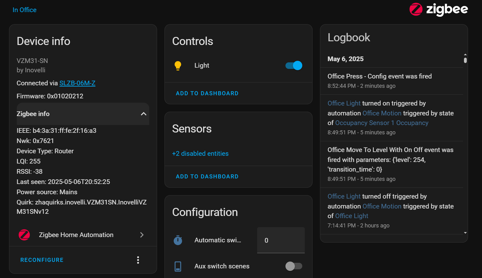

Not sure what to tell you to try to fix it, but that same combination does seem to work for me:
(Except mine is ZHA rather than MQTT)
Thanks, but this doesn’t really help me at all since you are using ZHA.
