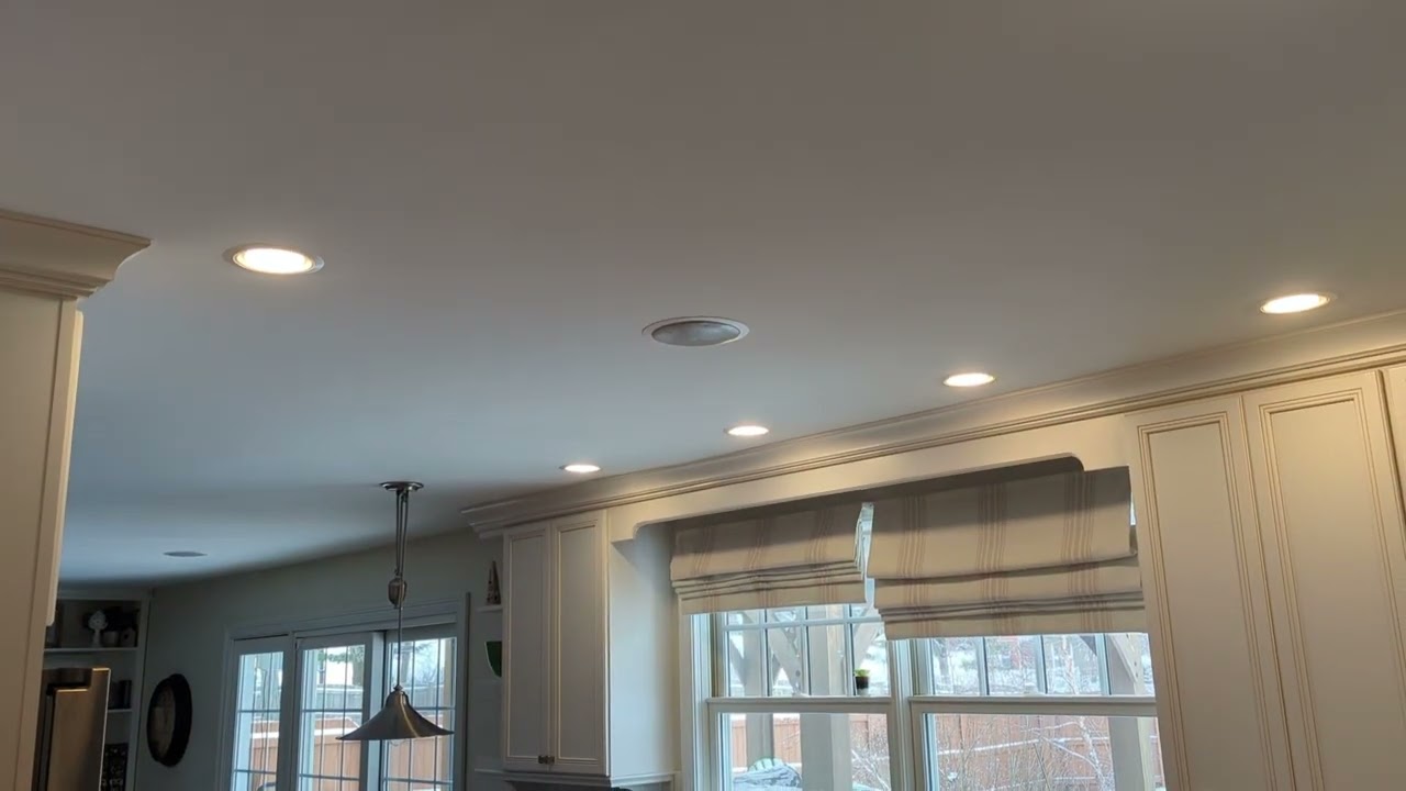

Here you go:
Did 3 power cycles. The first caused the light on the left to blink then turn off. The others worked fine.
The lights near the windows also do it occassionally. But if there’s one thing that is consistent, it’s the inconsistency by which this happens.
