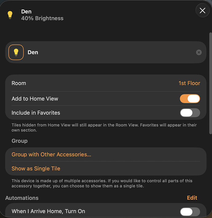

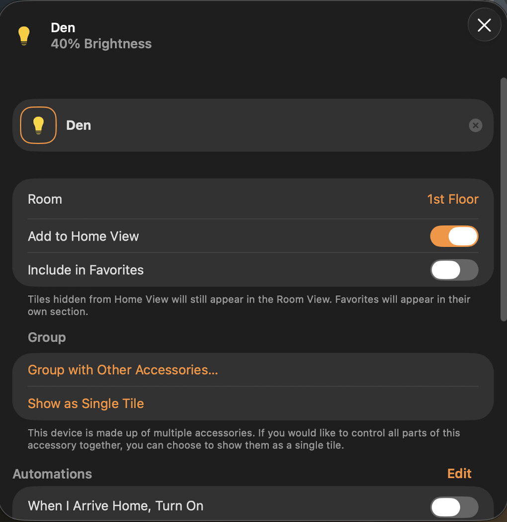

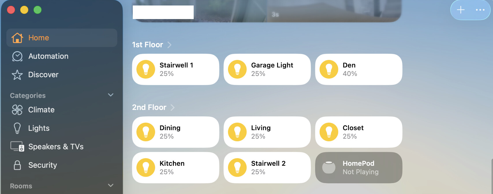

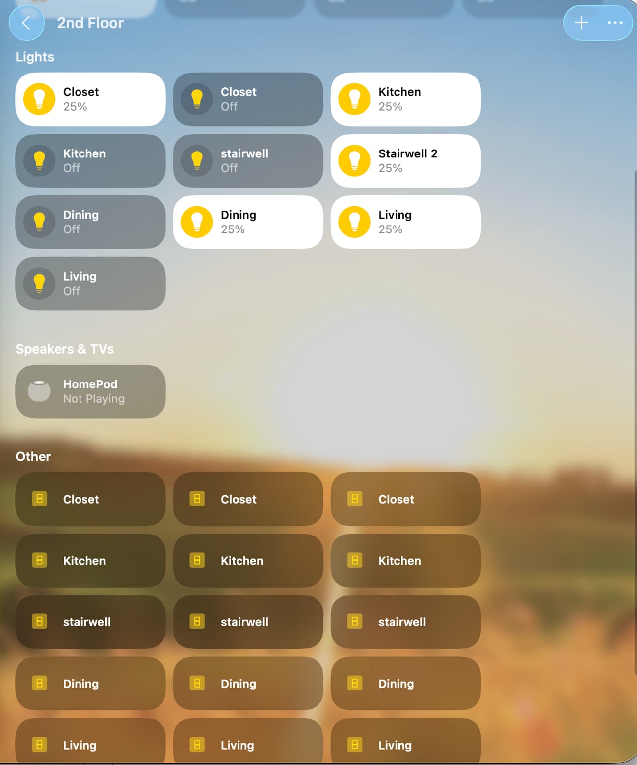

PS: I noticed big improvements to how buttons and the LED Bar are displayed in the UX. I like the lights to be displayed in the Home View only, hiding all other features. I found that I had to reset all of the switches and re-add them to simplify setup, a minor inconvenience to maximize how I want lights to appear.
