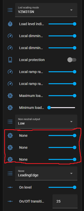

Hello, I have inovelli blue dimmer light switches installed, and configured in HomeAssistant through ZHA.
I can adjust most parameters through the HA UI, but there are three settings which appear as ‘None’, who’s function I am unable to determine. Please see the attached screenshot.
Is this a firmware, ZHA, or Inovelli HA integration bug?
For what it’s worth, individual LED control is also missing, but there are settings for default all led on/off color/intensity.

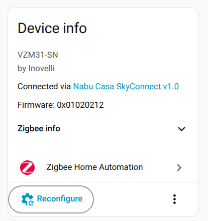

If you open the entity dialog do they have an entity ID that’s helpful? If not, you might try to reconfigure the device and have it re-interviewed. The only other thing I can think of would be removing the device and adding it again. I haven’t seen entities called “none” on any of mine.
I don’t think the individual LEDs are exposed as entities in ZHA like they are in Z2M. I’ve written a blueprint and script to help with that, in case you’re interested.
