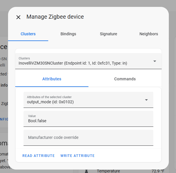

output mode set to 0 (this is dimmer mode) It doesn’t actually convert it to a dimmer, it just makes it act like a dimmer to bound devices.

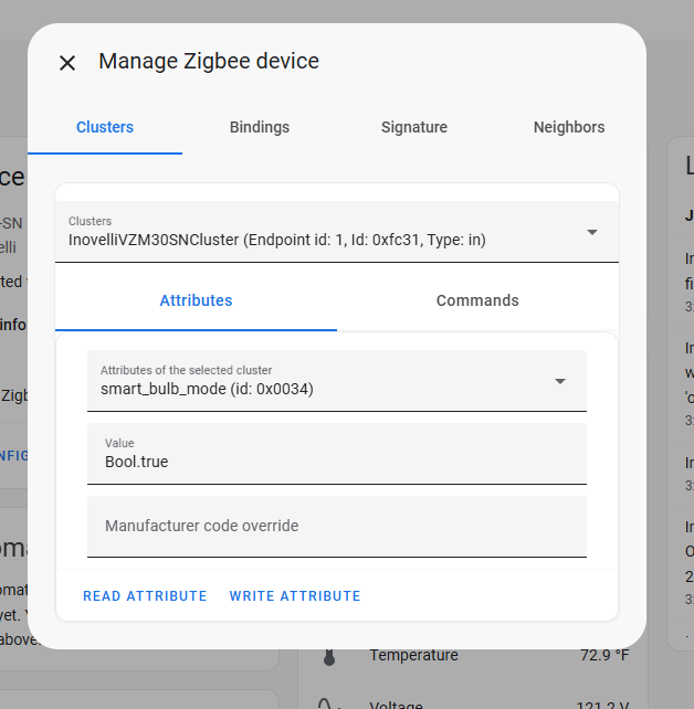

smartbulb mode set to 1

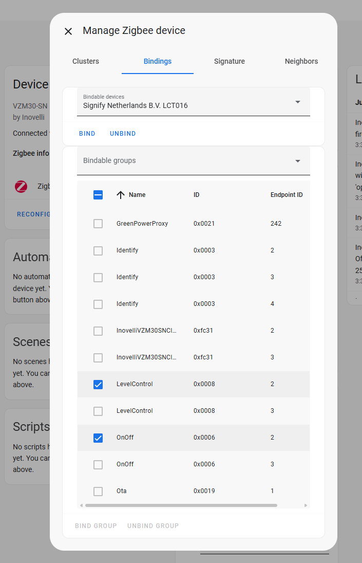

Bound bulb on ep 2 with the on/off clusters and level clusters:

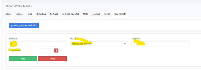

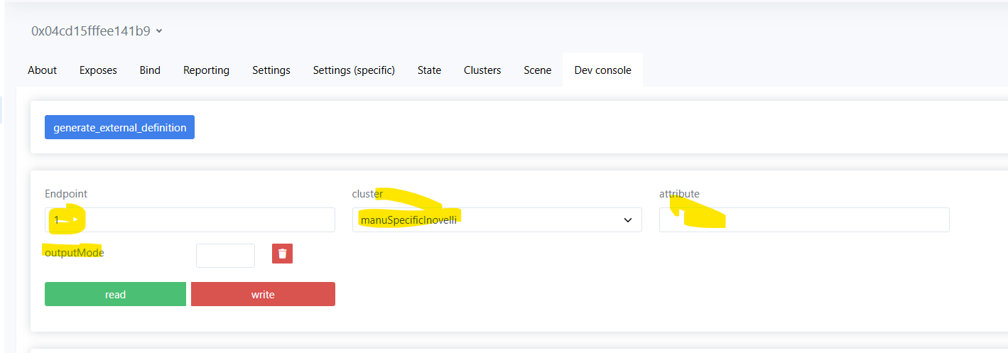

Hmmm, I wonder how it got left out. I’ll work on getting a PR to get it added. In the meantime, can you change the mode via the Dev console for the device:

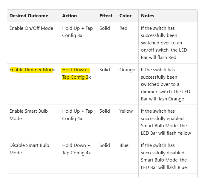

You can also switch it over to dimmer mode with the button combo:

You both are the best, thank you! I was able to adjust the output mode with the dev console and can confirm it’s working as expected. Not a firmware bug!
