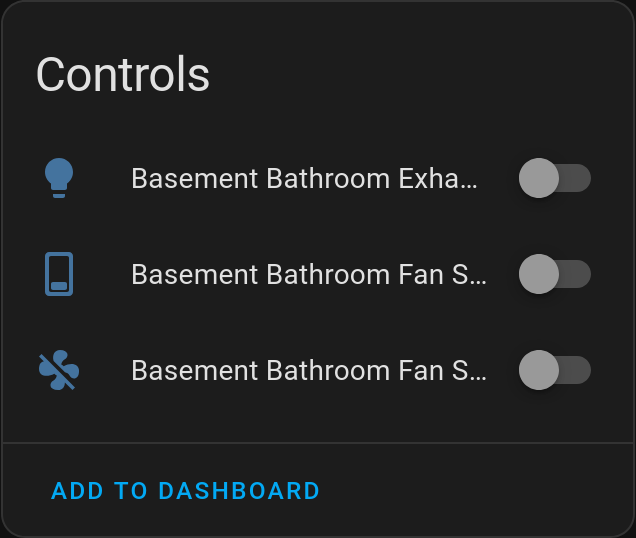

I’m using z2m and the VZM30 is showing as a light not a switch which means I can’t reassign this to its correct usage within Home Assistant. Does anyone know a workaround?

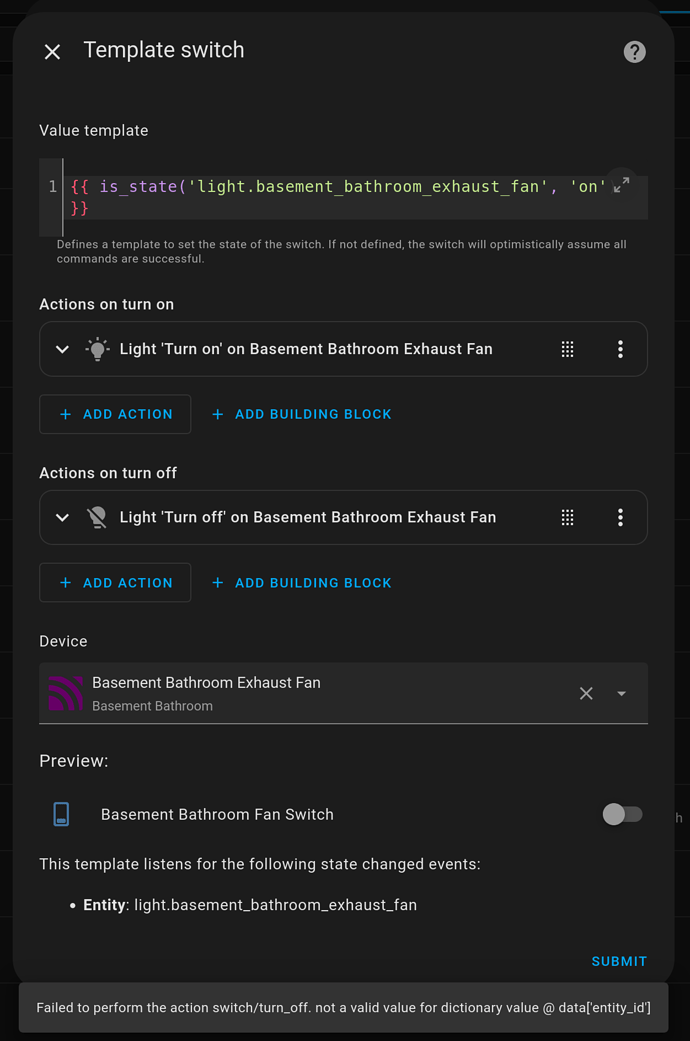

I’m currently attempting to use this for the template switches template:
{{ is_state('light.basement_bathroom_exhaust_fan', 'on') }}
Then using the actions to turn on / off the light service, but this just made the switch and the actual light states non-operational sadly.

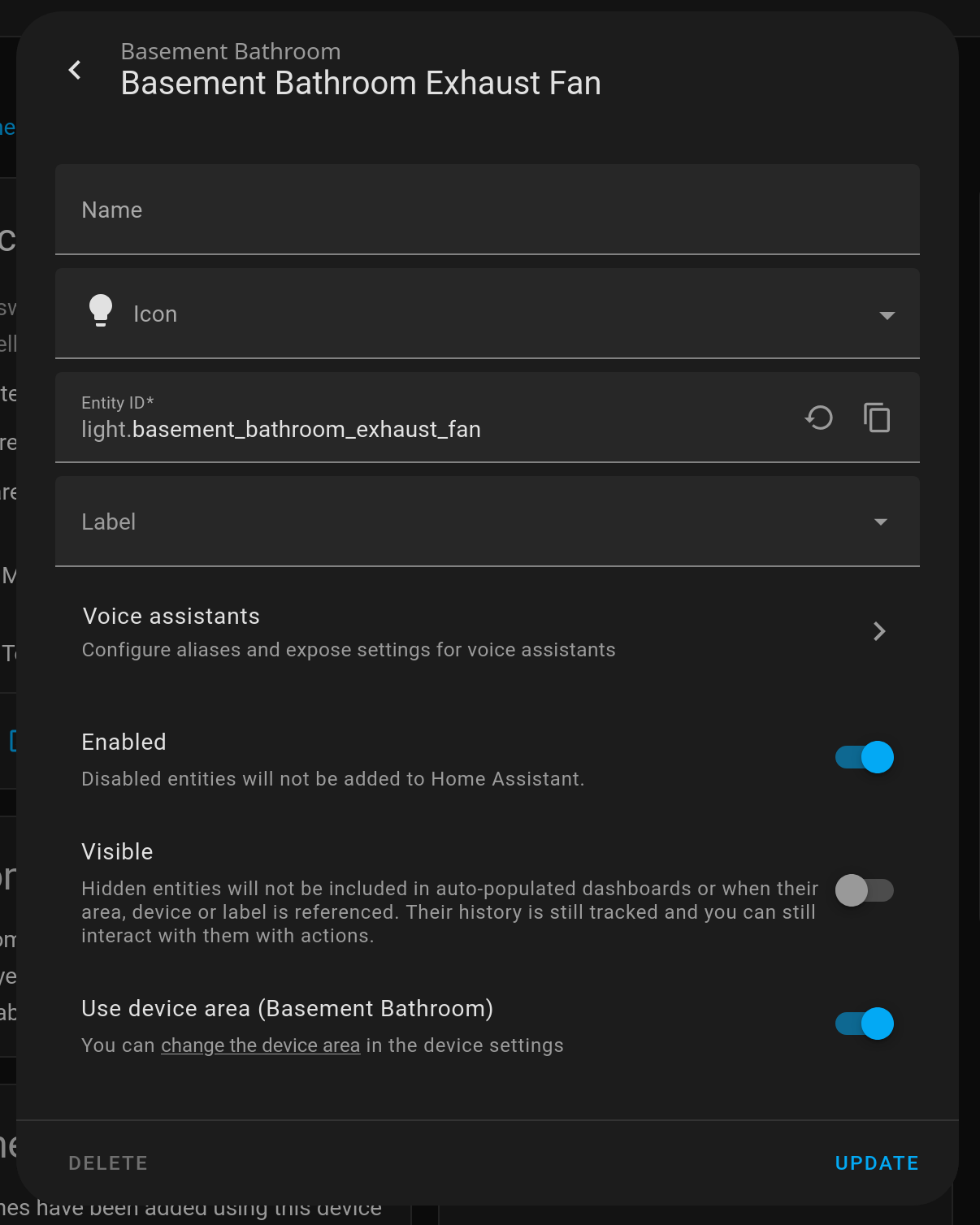

You can mark the entities that you don’t want for the device “hidden” so that they disappear from the list on the device page.
Thanks for pointing out to hide it, I was not thinking about that.

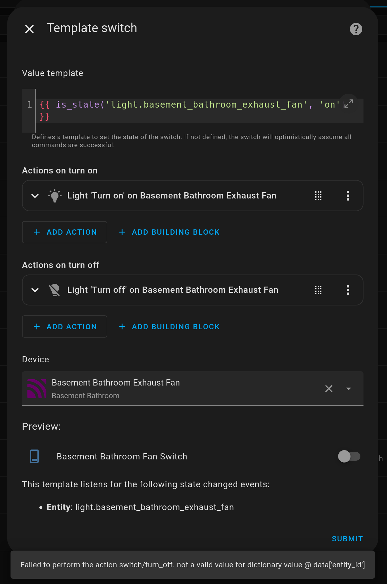

Oddly now it just suddenly stopped working and I’m getting a weird dictionary error, but I can’t quite fathom why. My other switch is working. Maybe this is somehow related to the multiple steps now?
So that error appears to come and go for me and I’m not quite sure why but it’s happening on both switches. One works then suddenly stops, seems to go back and for so far.
Ah! So if you mark the light as hidden in Home Assistant these workarounds break. So you’ll just always have a light and a switch and if you have a valid translation (such as a fan) for Switch as a then you just get that one since it marks the intermediate as hidden but the original light you cannot mark as hidden or this breaks.
Which of course then breaks actions on areas since I can no longer just turn on the lights in that area and actually only get lights. Now I turn on the lights and all my things, neither of which is good for my scenario especially given voice assistant since it simply won’t know to ignore these.
I don’t think I could say this is a viable workaround and presenting as a light to home assistant is problematic when the user chooses to not use it as a light switch (which I’d argue is the expected behavior, I think presenting a VZ31 as a light switch is logical).
Did you mark it as hidden or as disabled? I’ve not had the behavior you described when it was hidden, only disabled. I am lagging a few versions behind on Home Assistant though (2025.4) so maybe the behavior changed at some point.
Marking this as “Visible” to the off value breaks this for me while still leaving this as “Enabled”. I did double check this!

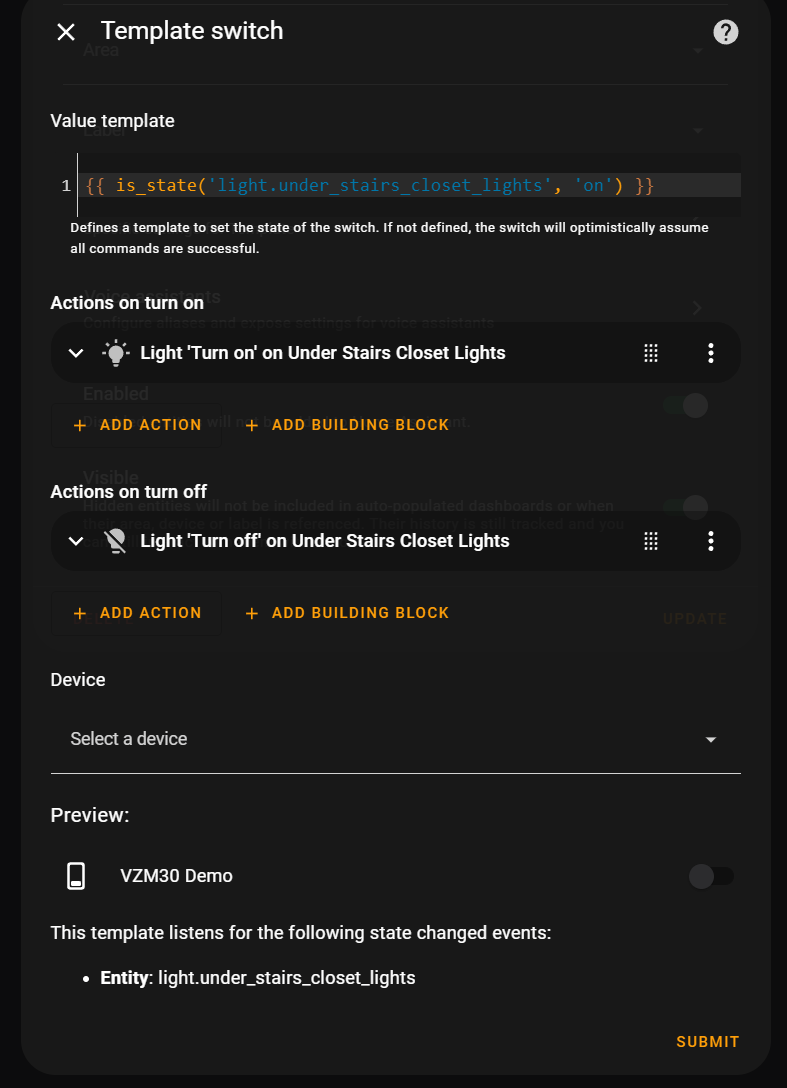

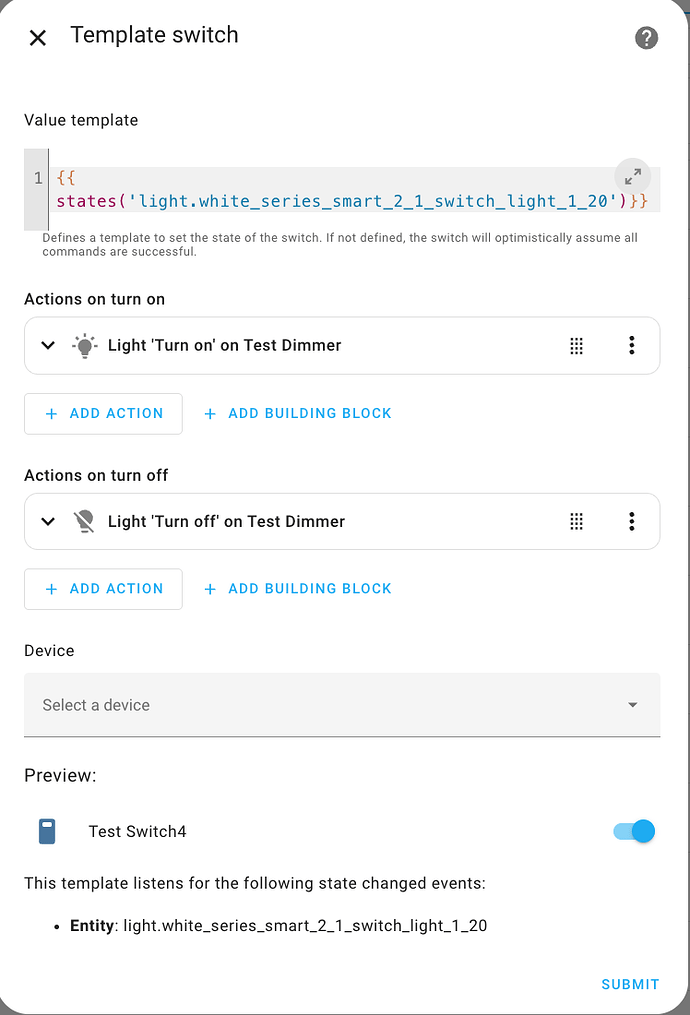

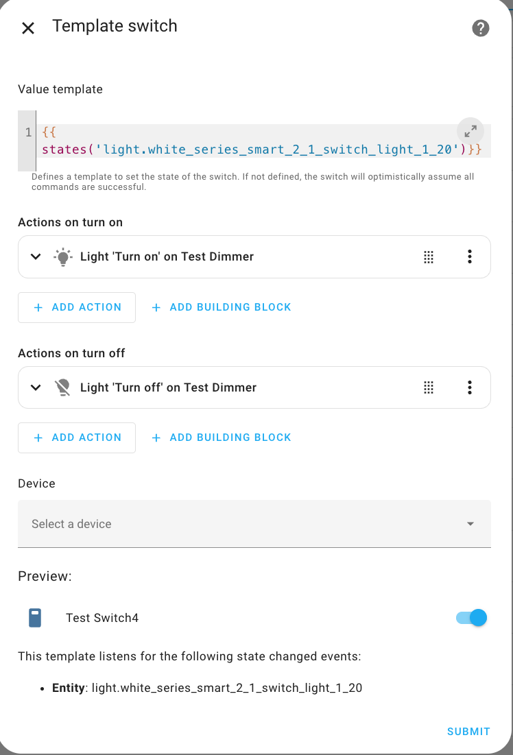

This configuration seems to work (using a white dimmer to create a switch). It’s very similar in approach to the YAML template that was originally posted by @jvm33 (I think) a while ago but using the template generator. I’ve used variants of that original template on most of the dimmers configured for On/Off operation that I have installed.
The dimmer itself is marked as “hidden” (“Visible” is unchecked).
Note that in the “Actions on turn on” and and “Actions on turn off” you must add the entity associated with the dimmer not the device,

@andrewk’s comments about using the entity and not the device made the difference for me. Seems that was the part that was missing to make this whole solution work, even though it’s a bit of a pain to have to work-around this. I still wish this product was just a “switch” instead of a “light” when it appears in Home Assistant.
