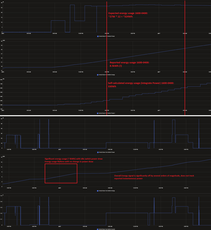

I wanted to report another potential firmware bug related to the reported energy on a VZM30-SN. I use the switch with HA Z2M. Please see the images below for some sample datasets.
Thank you!
Summary:
  • Switch’s reported energy is off by several orders of magnitude compared to energy as by the reported instantaneous power signal (8.5kWh vs 324Wh in one example below)
  • Switch’s reported energy continues to climb by multiple kWh (3kWh over 4 hours in lower example) despite being at idle power draw for the entire duration
    • I did a crude cross check at my meter and this does not appear to be a real load. I haven’t reopened the wall and measured with my current clamp yet
  • Switch’s reported energy alternates between climbing at a high rate (~500-1000W) or flattens (expected) during a continuous period of idle power draw

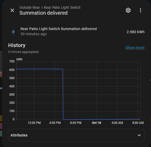

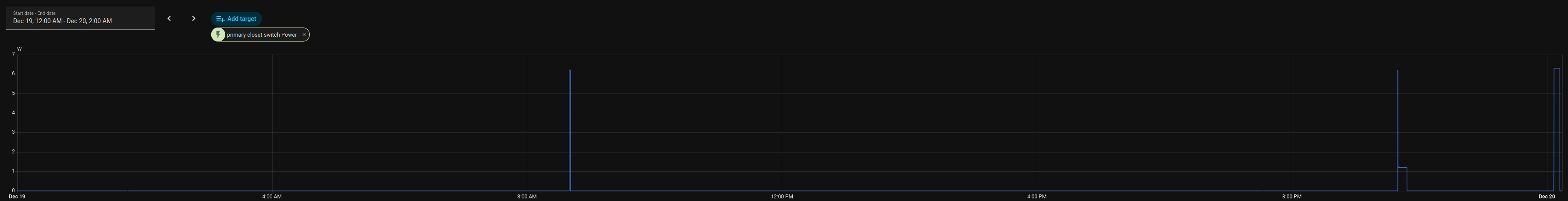

I believe I’m still experiencing this issue.
I’m pretty sure that I have the latest version. Home Assistant is showing firmware 0x01100101, and it’s also saying I have the latest.
I performed a factory reset, re-added, and reconfigured. The following shows the reset of the power consumption that resulted:

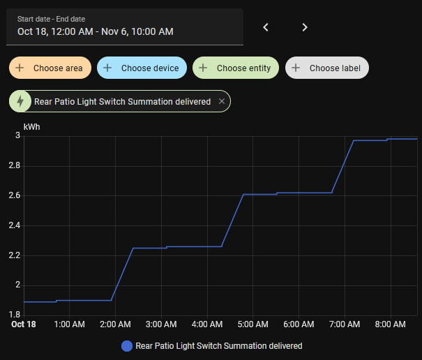

This a more zoomed in recent window of data since the reset:
This switch is configured in smart bulb mode. There is a downstream ceiling fan that is off most of the time, and a smart outlet powering some LED lights that is also off most of the time. Everything was off in the period shown in the second graph above.
What steps should I take to try and get this working properly?

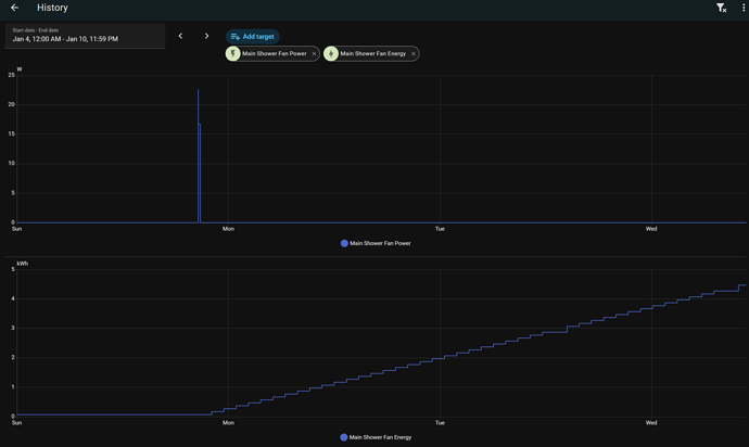

I’m also seeing this issue. I just installed the switches a few weeks ago. I’m on firmware version 1.02. It just started happening a few days ago.
Here’s my power output showing it hasn’t been turned on in 3 days with constant energy usage increasing since it powered off:
This switch has only been on firmware 1.02, so I suspect the bug is still present.
