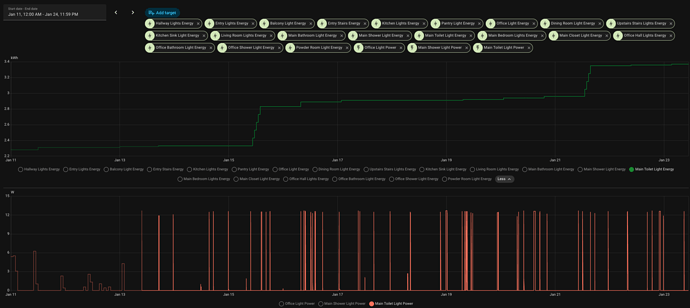

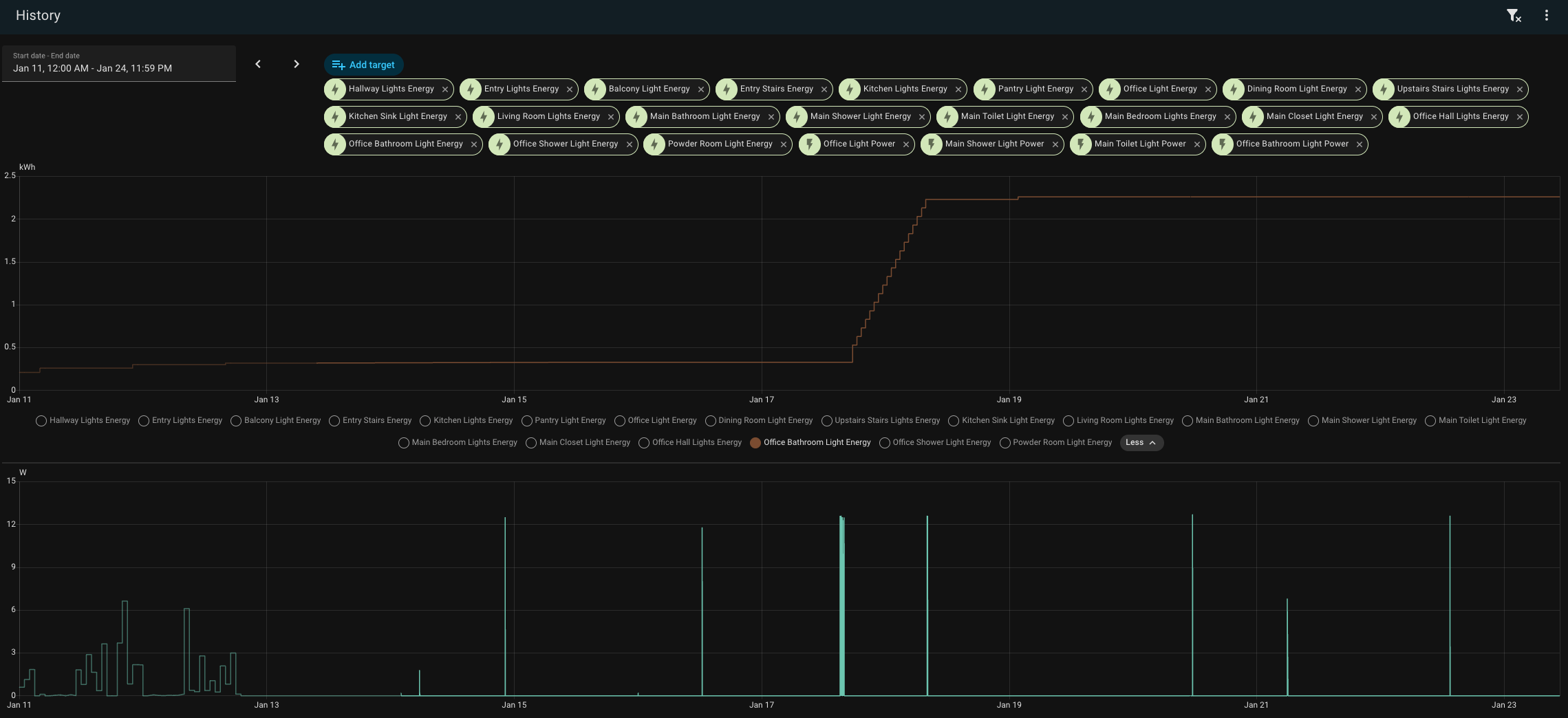

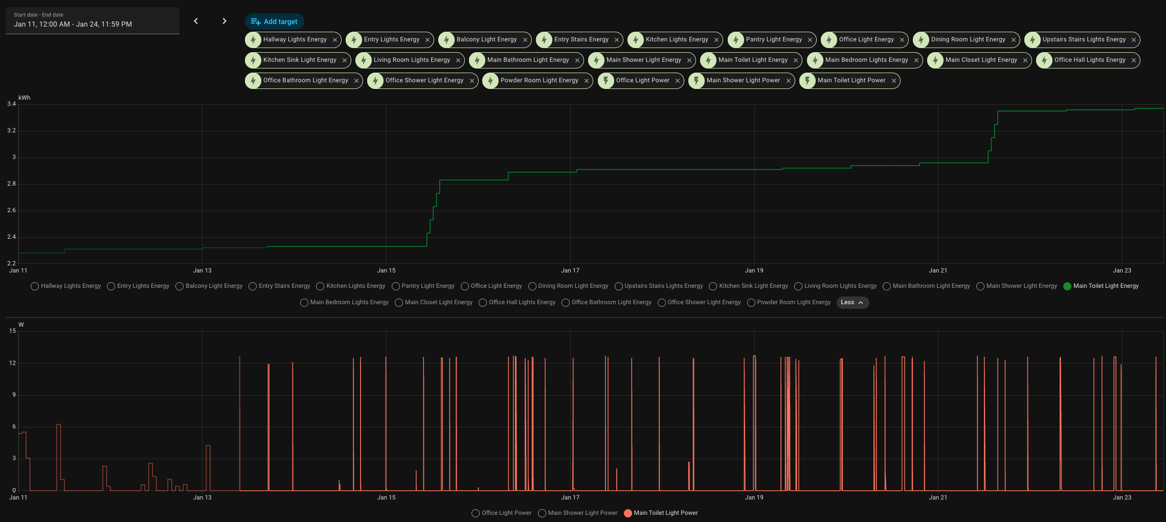

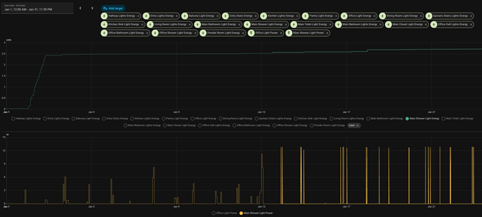

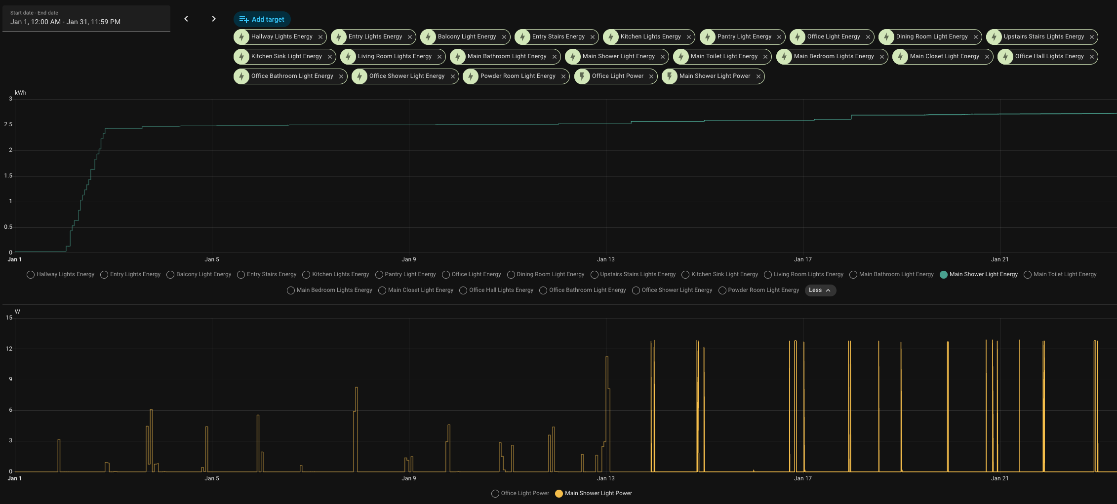

I’m seeing the same issue on many of my VZM32-SN dimmers. Here’s my most obvious examples:

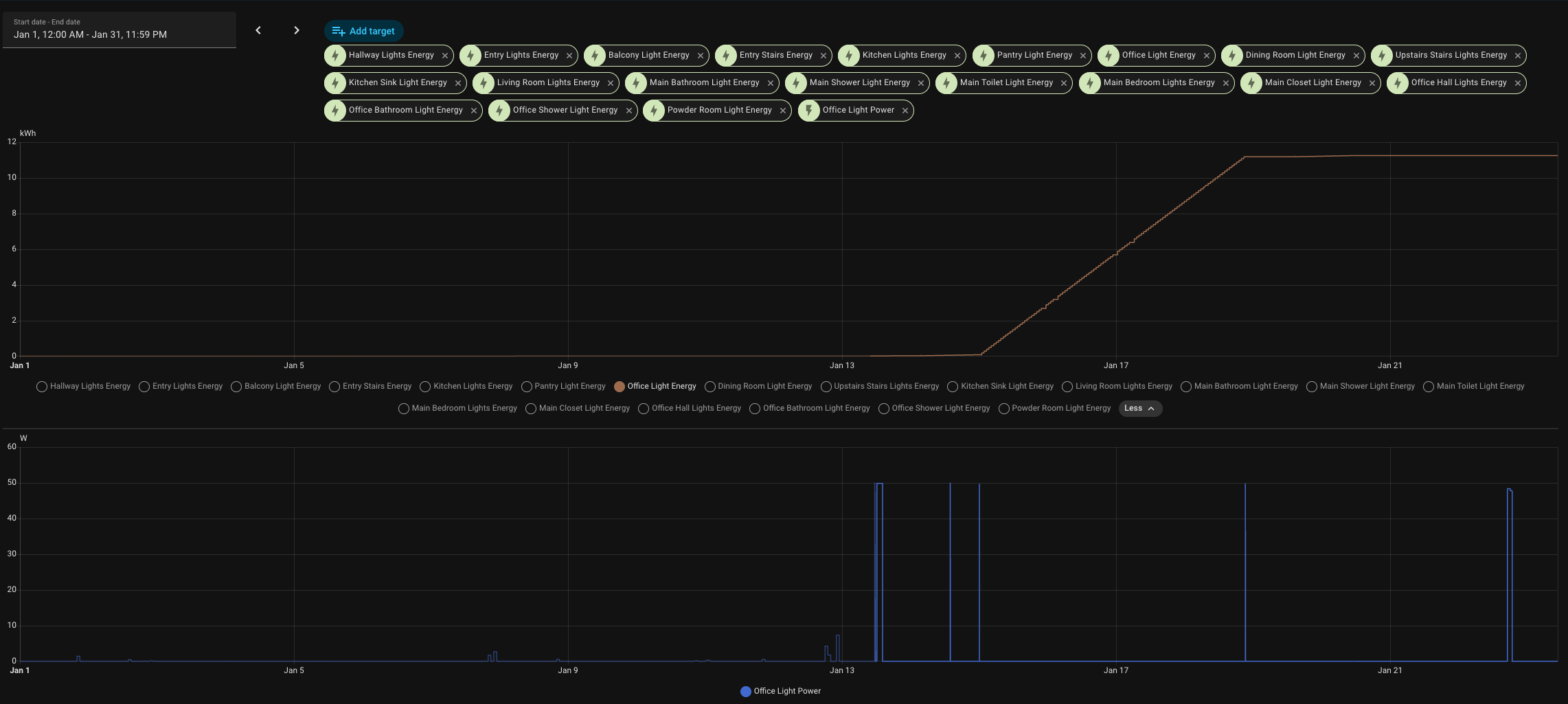

Maybe another interesting thing seen on power measurements here is the drastic change in power reporting on Jan 13. I’m not really sure what that’s about.
There are two bugs in both of them. The zigbee sdk messed up the divisor for energy reporting and there is a leakage bug. I thought both were fixed in 1.03, but the divisor still does not seem right. The leaking is fixed though and it is fixed in 1.01 of the vzm32 firmware (in beta if you want to test it). The divisor is not correct though and will be fixed in a new version.
