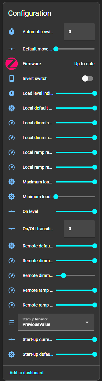

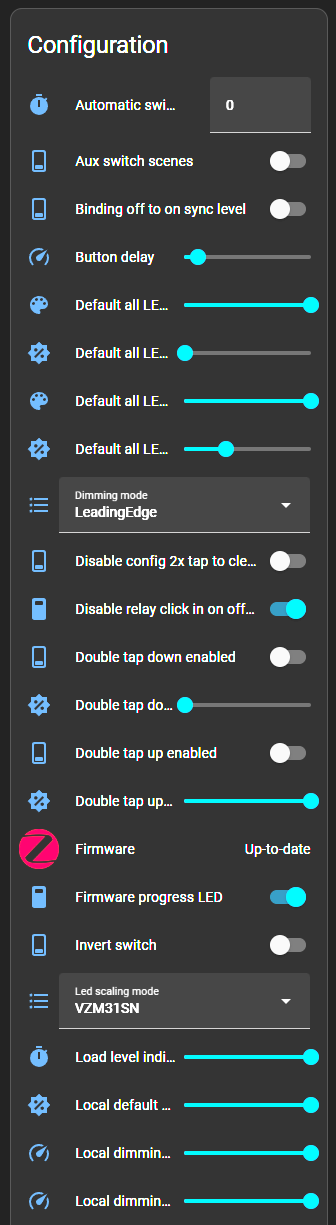

Older switches (added several months ago): 51 entities each
Newly added switches (added this week): 30 entities each

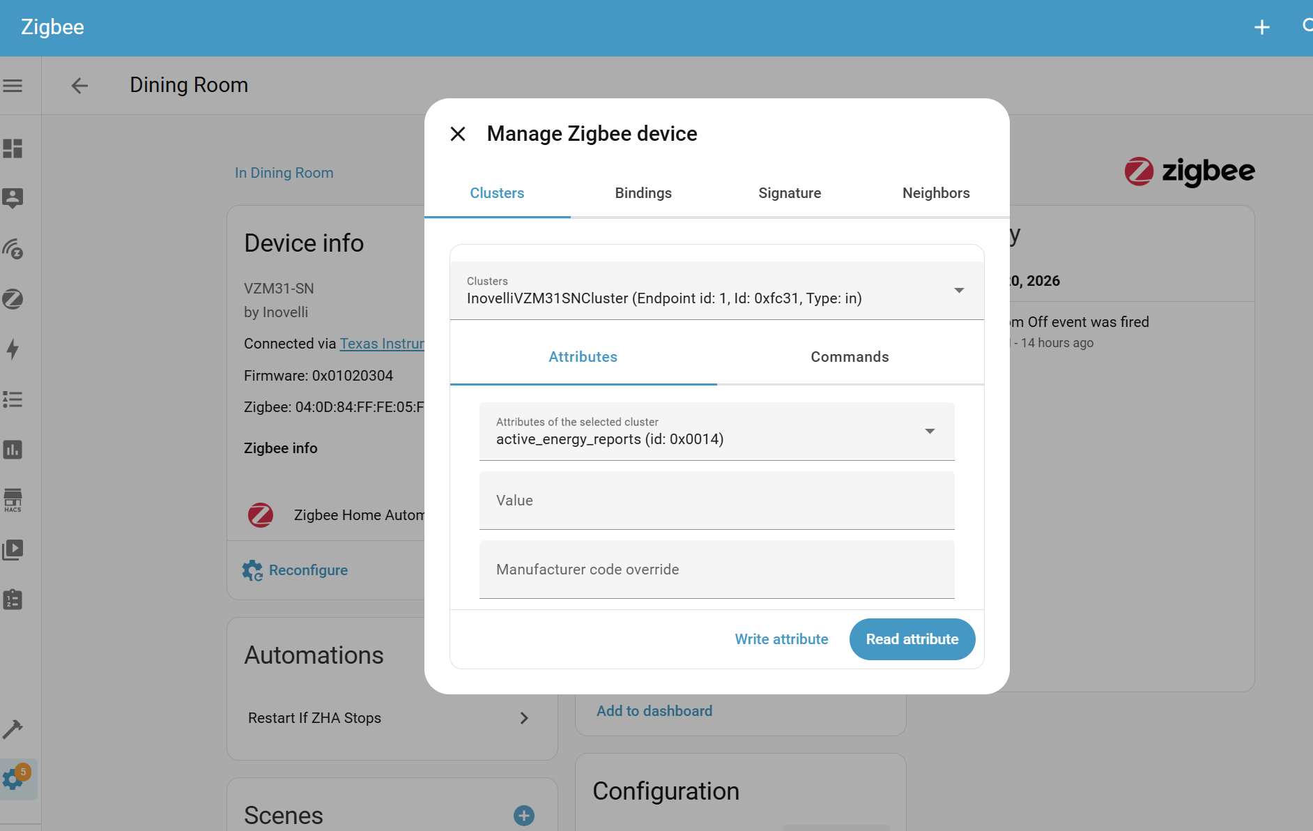

I’m running the latest updates to HA. I do see the inovelli clusters when managing the Zigbee Device. I’ve reset the re-added the device multiple times. Also, it’s running the 3.04 firmware.

I am seeing the same behaviour. My existing VZM31-SN switches show all 51 entities in HA, but a newly installed switches are only showing 30. Notably missing are all the entities regarding LEDs and multi-tap control.

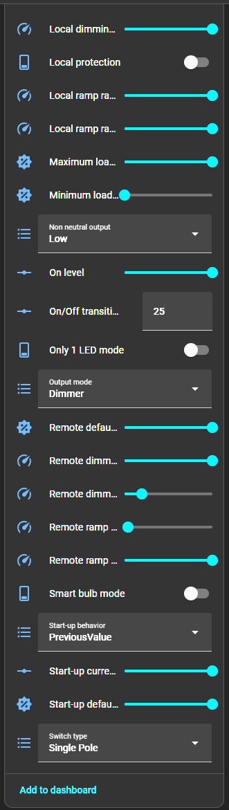

As a side note, you should be able to edit settings via “Manage Zigbee Device” menu in the device as a workaround until it can get figured out:
