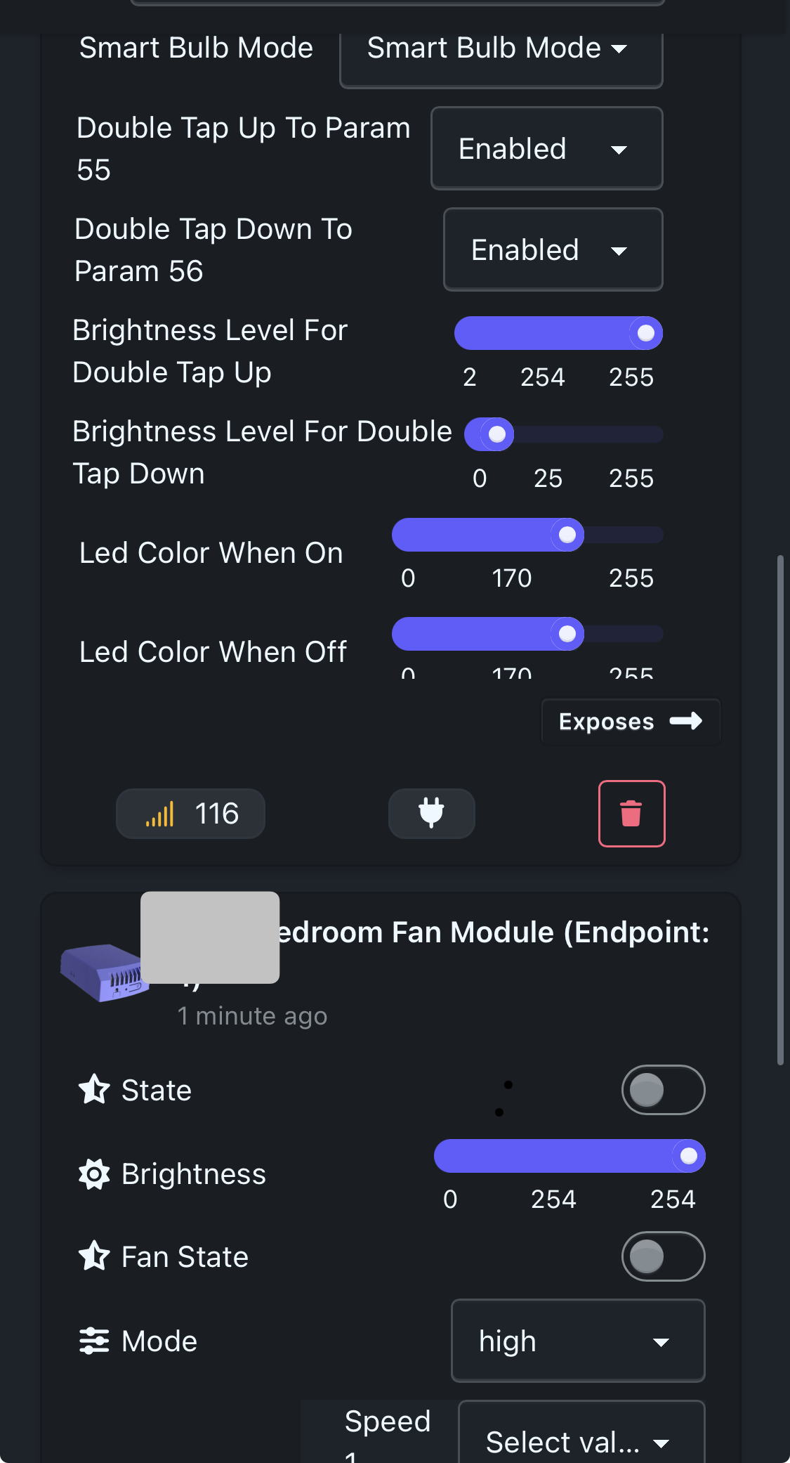

Here’s how my VZM31-SN looks in Z2M… I only have double tap up enabled, but it controls my VZM36 when I do so.

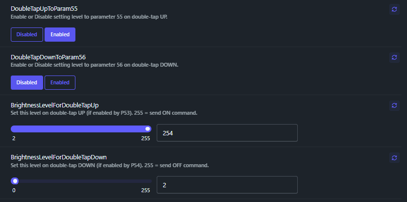

I do, but I’m still not seeing the expected behavior. You can see some of my settings below:
Is button delay a requirement to detect the double tap? I have the button delay set to 0ms.
Yes. The switch cannot detect any multi taps if the button tap delay is 0ms.
