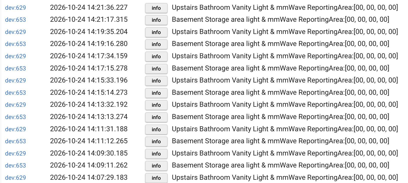

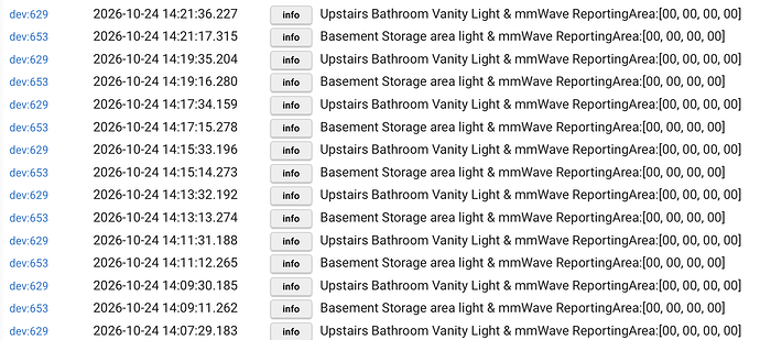

The VZM32-SN mmWave Dimmer Blue Series driver constantly reports the following info in the logs, even with the info logging disabled (Driver version 2026-07-10):

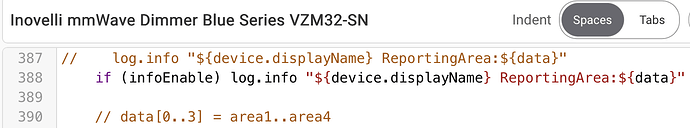

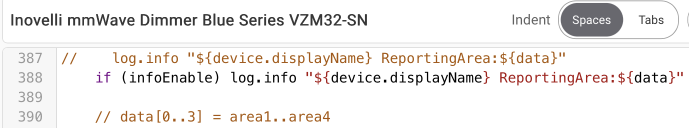

Claude recommends the following change and it has eliminated the issue (Replace lines 387 with new line 388):
