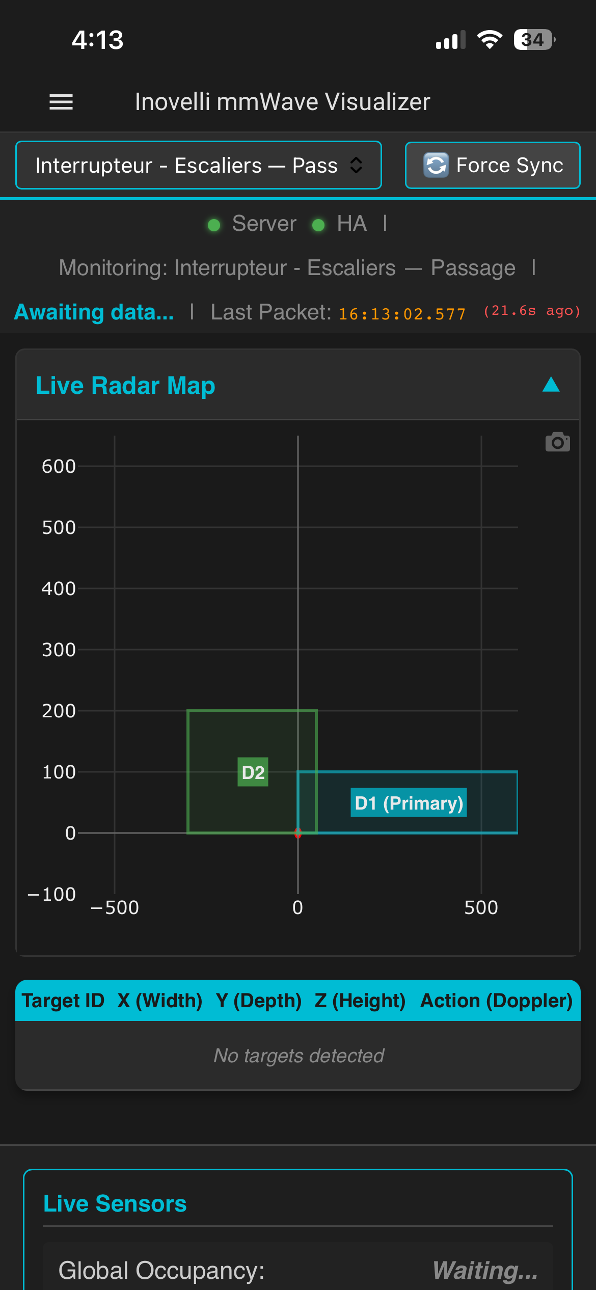

I don’t think it is easily doable within HA, but using the mmwave visualizer tool, I have been able to configure a 2nd zone on my device. Scroll down and look under Zone Editor where you should be able to draw a square to define the additional zones.
