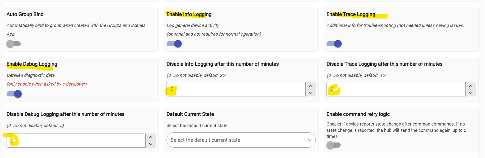

I don’t see that in your logs, but I do see a packet from the LEVEL_CONTROL_CLUSTER. This makes me think the binding is correct. Just to confirm you have all of these enabled? Also set the timeout to 0 so the logging doesn’t turn off:

Hey man, you are definitely not asking too much. I can confirm all three of those logging toggles were active. I did turn the logging back down when I had captured the events manually.
