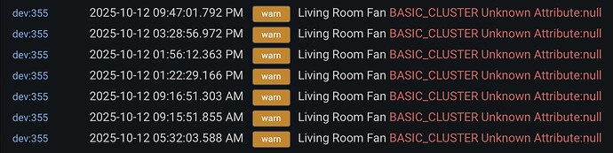

I see the switch regularly sending info back to the hub like the internal temperature, etc. So that’s more evidence that the communication between device and hub is good.
Trace logging turned up one single warning that doesn’t seem like a huge deal, but maybe is relevant?
2025-10-11 10:57:23.938 AM warn Living Room Fan Unknown Cluster:0x8001 catchall: 0000 8001 00 00 0040 00 E49E 00 00 0000 00 00 90009B5D1BFEFF2787049EE4

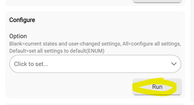

Can you verify the mode of the switch? Also, try to just hit the configure button once to make sure.
Hey Eric! Yeah, I noticed the same thing when bringing the new switch into the hub - the driver didn’t detect it but switching the device type after pairing didn’t seem to cause any problems.

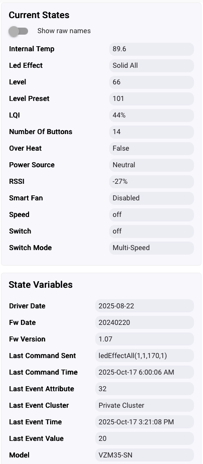

Can confirm the switch is in Multi-Speed/Celing Fan mode (see attached) - I set this using the switch taps when I first powered it up and confirmed it’s also set in the device parameters
If I run ‘initialize’ 2 or 3 times after sending a speed or switch change to the device, I can pretty reliably get back the status. But obviously, nobody wants me to have to do that. That’s like something I had to do way way back when with some old GE Jasco Z-wave switches that didn’t send updates and had to be polled.
You did run the configure command?
When you set the speed here, does it eventually update in the Current States area?
Yup, I’ve run Configure dozens of times and it has no visible impact. When I send speed changes it doesn’t reflect in the status until I button mash “initialize” like I’m playing street fighter.

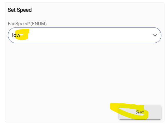

Can you turn all the logging on and then set the speed via the device page and record the logs?
Of course, here you go. I couldn’t upload a log file so, sorry it’s in a codeblock
