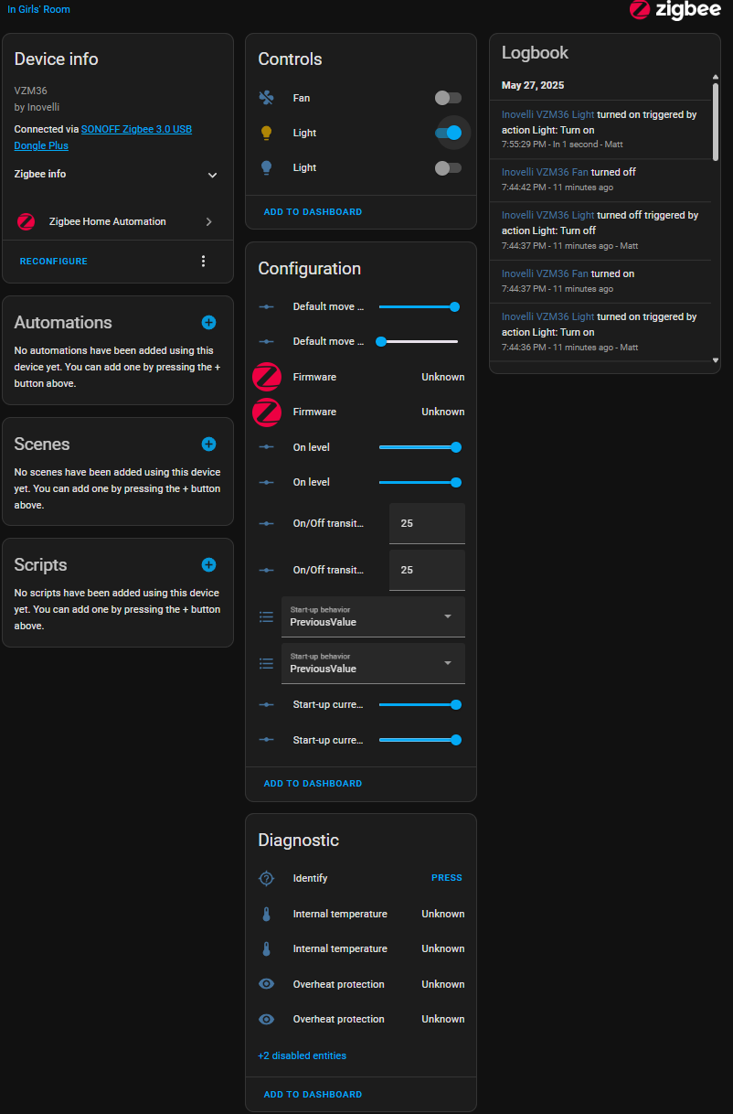

Hey there! I’ve just connected my first VZM36 canopy module and I seem to have two independent light entities in home assistant. They’re labeled light.inovelli_vzm36_light and light.inovelli_vzm36_light2…
I assume this is a weird bug, do i need to force a firmware upgrade or do a factory reset or something? I just have this and a VZM31-SN sitting on my desk connected to the wall so I could pre-configure before getting the ladder out, lol.
Just wanted to add that I powered up my second canopy module and it’s the same thing, the light control and all configs/diags are duplicated.
Seems this is intended? The fan and the second light are bound together, idk why the second fan control isn’t called a fan but whatever: Zigbee Fan Canopy Module | Project Cheryl - #557 by CodeMaster
