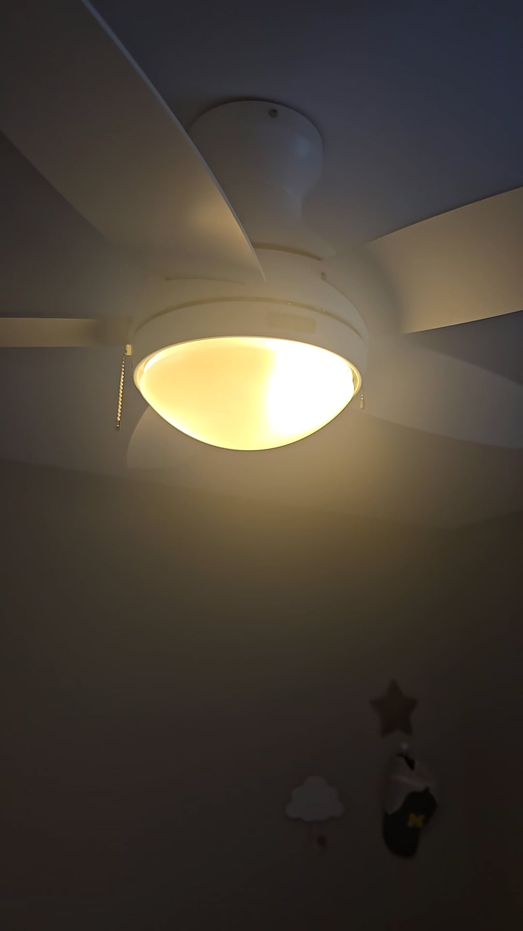

I’m having an issue when dimming the light from the paddle. The light dims but as soon as the paddle is released the light “springs” back up in brightness quite a substantial amount (but not back to the starting level).
Interestingly this does not happen when dimming via HomeAssistant.
When the dimming stops, HA reports both the switch and the fan module at the same percentage.
Here’s a quick video, it doesn’t capture it super well but you see the idea:
The bulbs are dimmable LEDs but I’ve tried a few brands including some nice Cree bulbs and they all act this way.
Has anyone seen this before? Any idea if it’s fixable?
