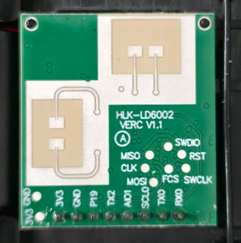

I purchased mmWave Red Presence Dimmers for bathrooms and a utility room, where the light switches face into the room and away from the rest of the house. The idea was that this layout would reduce the chance of picking up movement in nearby rooms through the walls. A week in, I have to say the reliability of the motion detection far exceeds my expectations. This is most likely due to the mmwave sensor being of the 60 GHz kind, rather than does operating at 24GHz. With my initial worries gone, I’m now considering them for other rooms as well.

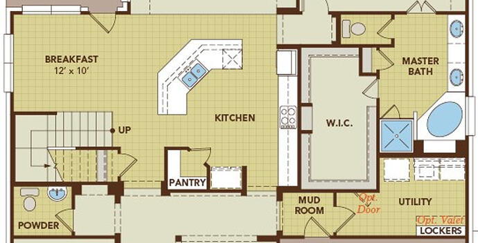

Walk In Closet Install:
I’d like to replace an old Jasco Motion Light (the one that originally triggered the development of this dimmer} in the master walk-in closet. The dimmer would point into the WIC and toward the kitchen on the other side of the wall. Anyone know how prone to false motion detections this setup might be?

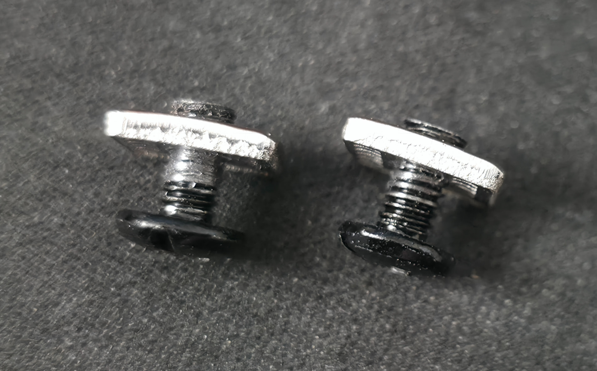

Compared to the other dozens of Inovelli switches and dimmers in my home, I had the impression that this model’s design has little room for tolerances given the very tight fit of its paddle seemingly causing a slight bowing of paddle. Also, the screw metal seems softer than all my other dimmers as both load-side screws were either already stripped or did so way too easily.
I found Inovelli’s official suggestion to either send the unit in for repair or request a replacement screw for a DIY fix. Since I have plenty of old smart switches, dimmers, and outlets, I harvested screws with attached nuts from an old Jasco fan switch. Using a caliper, I confirmed they were virtually identical in size and they appear to be stronger.
I’ve installed hundreds of devices from several brands and have never had screws strip on me, so I can’t say I’m thrilled. That said, the repair itself was very easy even though I worried the very tight fit of the paddle would result in broken plastic tabs.
The final installation went smoothly and works without issues.
