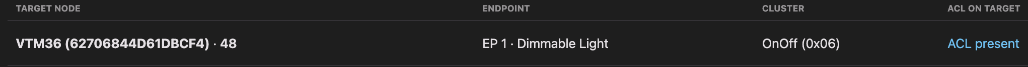

And here’s how I bound the switch to the module:
  1. from the Matter Server page, selected the switch from the devices list (Node 44 in my case)
  2. selected Endpoint 2
  3. clicked Add Binding
  4. selected canopy module device (node 48 in my case)
  5. selected endpoint 1 (light) and on/off cluster
  6. navigated to the Home Assistant devices page, selected the switch
  7. set the switch’s “Control of switch load” to “Remote & paddle control” ← THIS WAS KEY
  8. set the “Smart Bulb Mode” to “Smart Bulb Enabled”
  9. power cycled both devices (i.e. breaker) - not sure if this actually was required
After that, the switch could turn the canopy light on and off!
