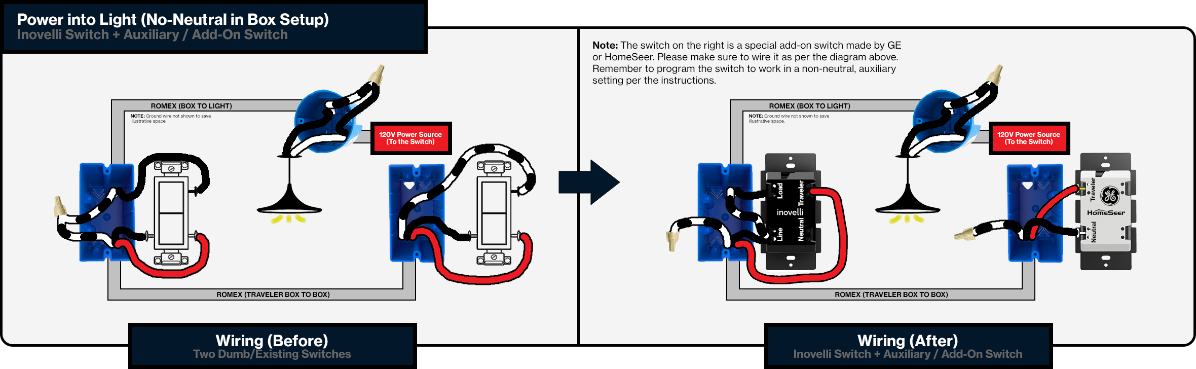

My hallway is 3-way switch without neutral.
So I set up with approach with 45710 Auxiliary/ Add-On Switch

Once everything is working as a 2-way, rewire adding the red and black from the 3-wire to the Inovelli. You’ll need to put the switch in the 3-way + Aux mode. Again, see the quick tap article.

btw. i am using a wago to link the line from lamp and to inovelli and aux switch. Should I directly put the line wire for aux to inovelli switch directly to make the aux work?
Doesn’t matter so long as the connections are sound. The two techniques that you described are electrically the same. That being said, it is cleaner to use both holes on the switch rather than adding a Wago and a pigtail.
