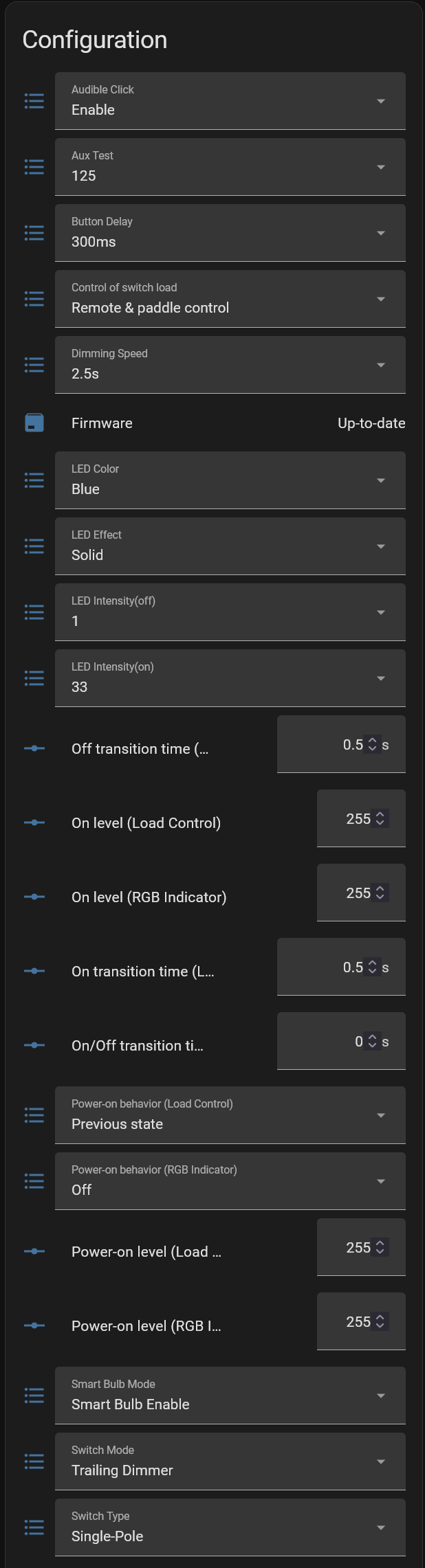

Here are all the configuration options currently available in Home Assistant for me as of White Series Dimmer Switch firmware 1.1.5:
Sorry about the ones that were cut off, for those:
Load Control On Transition Time and Off Transition Time are separately configurable. For the RGB indicator, you just get an On/Off Transition Time configuration.
I had never attempted to change Power-on Level or On-level for the load control or LED indicator in Home Assistant, the 255 value is apparently the default. I did find a help article for this switch with the Local Configuration Table included, but those particular configuration options in Home Assistant don’t seem to directly correlate to any of the parameter values in the help article: White Series Dimmer Switch • Button Combinations, Quick Tap Sequences & Local Configuration Options | Inovelli Help Center
