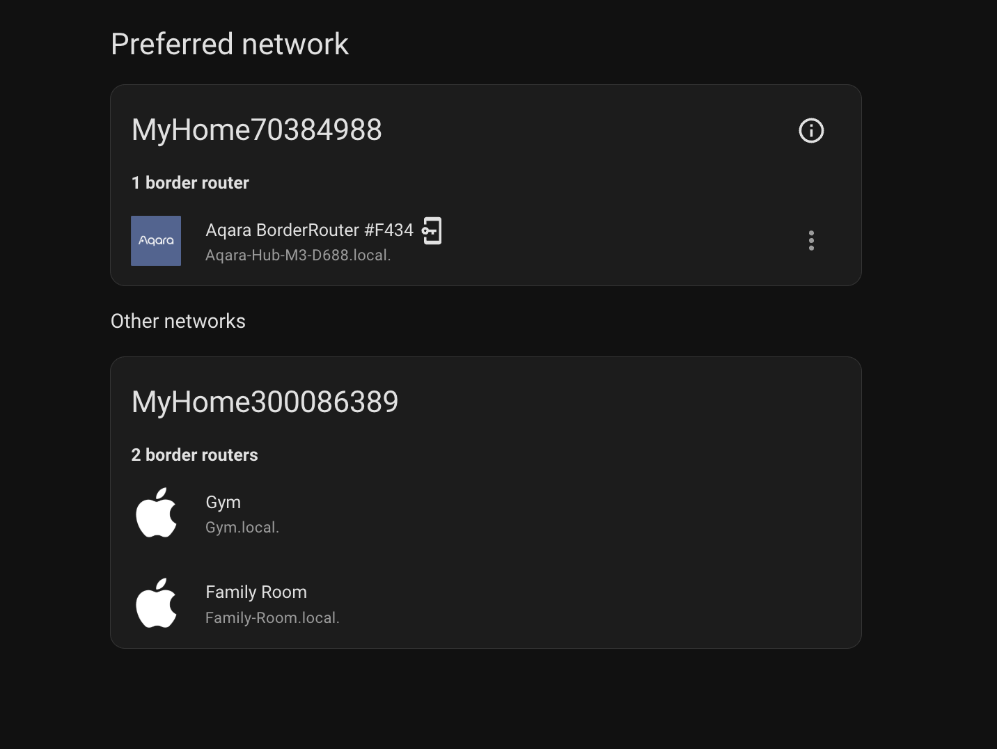

I could not make my Apple TV 4K thread network as preferred network.
Is there a trick. I bought Aqara Hub Gen3 and make it preferred thread network without any problem
It’s a confusing question. Are you saying you can’t add the white fan switch to apple home? You say you can make Aqara hub the “preferred thread network” by that do you mean you can add them to Aquara hub using their commissioning processes? What model Apple TV 4k do you have. They don’t all support being a Thread Border Router even though they all support matter.
I am not saying that I can’t add white fan - I do not have white fan switch. What I am saying - I can’t make Apple TV 4K network as a preferred thread network.
Sorry, my bad I didn’t see your question was about home assistant. Is that screen from your phone or from your computer?
You should have 3 dots and a button to send credentials. I think you have to have an iOS device to set it up.
