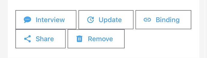

I’ve been setting up my White Series Dimmers and I started by adding them to Alexa, then I had Alexa to generate a code for then adding them into Home Assistant as well. I enabled beta downloads and have restarted HA several times, but I don’t see the “Binding” button when viewing a node. Is this because my devices need to be directly added into HA instead of being shared by Alexa, or did I miss a step somewhere?
Please help. This is driving me insane :sweat_smile:

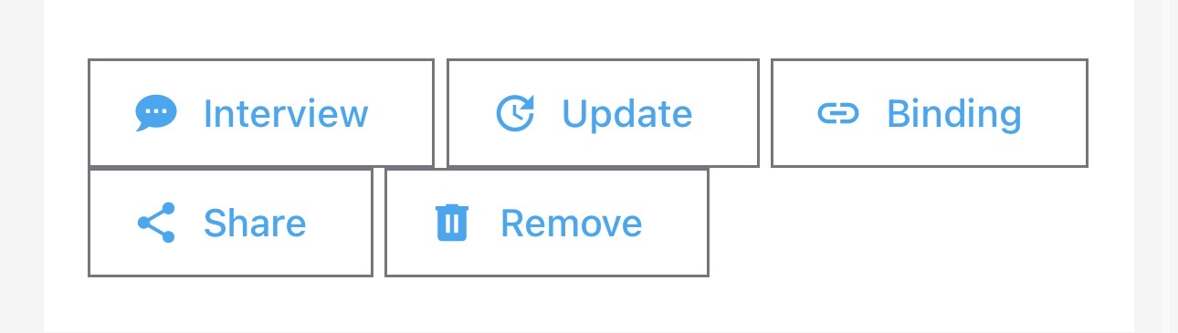

Found it! I eventually was able to find the binding cluster of the node, which is the only place the “Binding” button appears.

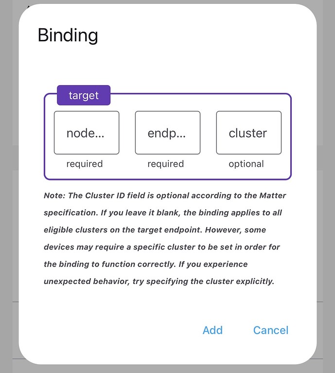

Next step is for me to find all details needed for the form…
