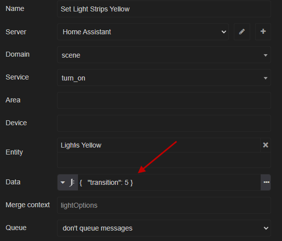

Possible bug: The Inovelli White dimmer switch in “dumb bulb” mode doesn’t support transitions when starting from 0 brightness.
transition
I’ve set up several scenes that are a mix of smart light bulbs and Inovelli White dimmer switches in “dumb bulb” mode. When setting the scene from Node Red (see attached image) the transition value is not respected for the switch when starting from 0 brightness, but IS respected when starting from any brightness >=1.(The transition value is respected by all of my smart bulbs regardless of the starting brightness of the bulb.)
The same thing occurs when using light.turn_on directly with the single switch, rather than turning on a scene.
I’ve experimented with setting the brightness on to 1 before setting the scene with a transition, and it works, but it feels like a lot of extra steps across all of my scenes.
Is this a bug? Has anyone gotten transitions to work from brightness=0 (ie, off)?
The Matter standard requires that Level Control values for lighting devices be between 1 and 254, so if the level control cluster is showing a 0, that’s the bug. For lighting devices, sending a 0 level should result in the on off cluster being set to off.
This behavior is specific to lighting devices. The level control cluster can be set to 0 for other device types. There is a specific feature flag on the level control cluster that indicates to the controller that the device has this behavior.
Also, I think setting 0 causes the device to capture the current level as a Global Scene and any later turning of the device back on through the on/off cluster recalls that last scene. I think this is all carry-over behavior from Zigbee.
This is a long and perhaps overly detailed way of saying you should not be starting any light transitions from 0!
This is from memory, but 99% sure I have it correct here.
