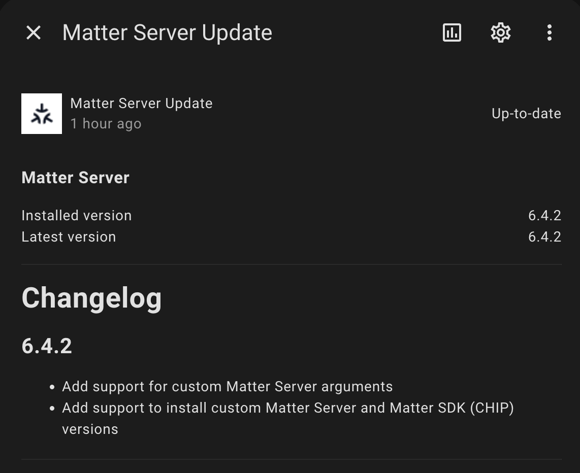

FWIW, they pushed out 6.4.2 today, which doesn’t sound like it contains any bug fixes per the changelog:

Actually, 6.4.2 allows some disablement of features/reversion to the Matter SDK being used. So I think the steps as suggested by the developer could be followed if you’re having these issues, to see if they help. Or you can just follow along and see what other folks are experiencing before making your own similar changes:
