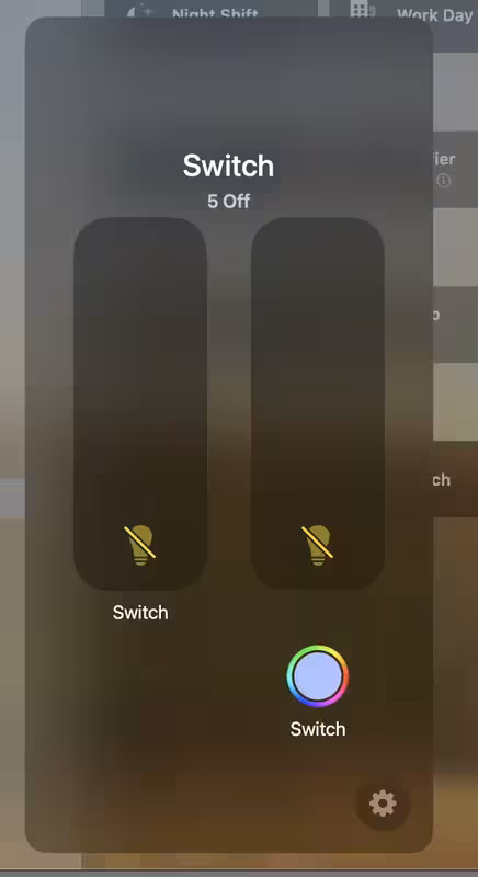

On to the switch:
I paired the switch to HomeKit then configured it to smart bulb mode using the up paddle and 4x button C presses.
In Homekit i am presented with 2 main tiles:
The first being the switch itself, where I can configure, single press, double press and long press for all 3 switches (paddle up/down and config). I can assign Homekit scenes and accessories to these and they work fine.
The 2nd tile presents as a ‘light’:
In there are there I can see the LED bar color selection presented in the lower right and above it that slider seems to represent the LED bar brightness. I suppose this is the ‘light’ I would use if I wanted to tie it to automations? What is the ‘light’ on the left for, since the switch is configured in smart bulb mode and is meant to default to on/off when in smart bulb mode what is that dimmer for?
