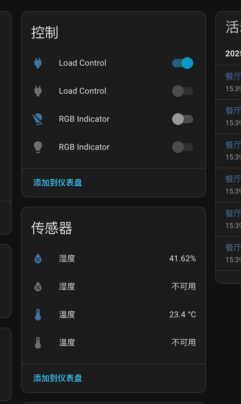

I just got another issue here. One of switch create duplicated entities. I tried to delete and pair again. But the duplicated entities still there.
I believe I’m having the same issue. White Series On/Off Switch, Home Assistant Core 2025.10.3. I can’t find the version number for Matter or Thread or OTBR, but they are all up to date.
I can control the device Load Control from Home Assistant, but that is the only thing that works. I am unable to change anything with the LED notification bar. The paddles on the switch itself do not work - I can only control the Load through HA. I do not see any Events show up from any of the three buttons in HA.

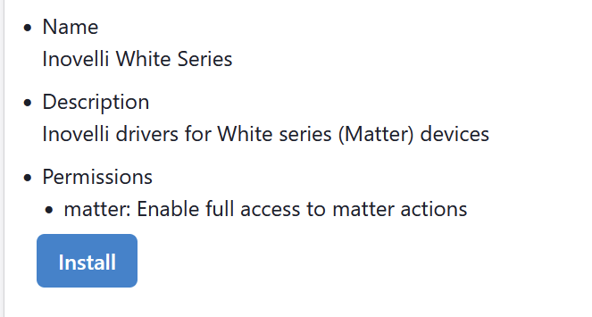

I don’t have any White switches, but I can point you to the published driver.
Did you load the driver from SmartThings. Add a little smartness to your things. ?
If so and ST is defaulting to their driver, it may be a fingerprint issue causing the Inovelli driver to not be selected.
See if you can manually change to the Inovelli driver. From the device’s page, select the Kebab menu at the top right, Driver, Select different driver.
Thanks! Yes, I already have that driver installed and it’s working fine with my White Series Dimmer models.
In the list of available drivers, I only see ā€œMatter Switchā€ and ā€œMatter Sensor,ā€ both provided by SmartThings. Switching to ā€œMatter Sensorā€ exposes the humidity readings, but disables control of the child devices. Unfortunately, I’m not offered any Inovelli-specific driver for this switch.
I agree with you—the fingerprint mismatch seems like a likely cause of the issue.

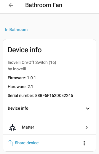

Okee dokee… I’ve upgraded to the new firmware, and I’m still getting the same behavior. After one cycle, the paddles and LED bar stop responding. I can continue to turn it on and off through Home Assistant or Apple Home. Both platforms are showing the new firmware version.
The load on my switch is an OEM Broan-Nutone replacement motor kit, BKR60 Broan-NuToneĀ® QuicKitā„¢ Bath Fan Replacement Motor and Cover/Grille, 60 CFM .
