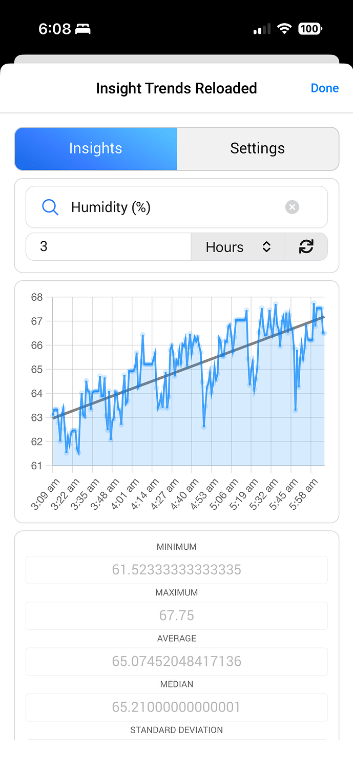

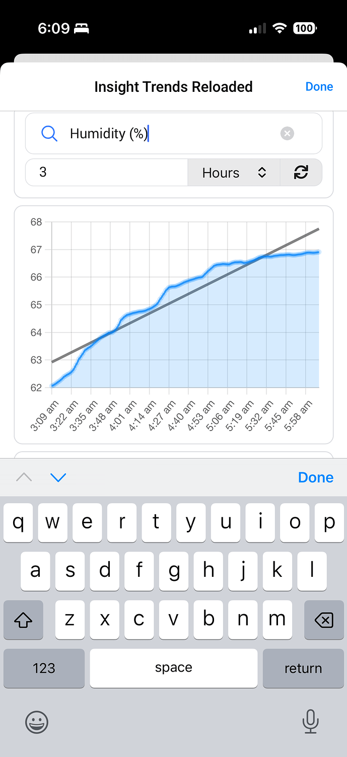

Hello, I’m wondering if anybody else has installed this switch and is getting extremely inconsistent readings from the humidity sensor (and temp for that matter) making it very difficult for an Apple home user to automate a bathroom fan.
I’ve attached the trend over a 3 hour period for this sensor vs the arre temp sensor in an adjacent bathroom.

This is discussed in one of the threads about about this feature (I think the zigbee thread). The sensors are heat sensitive, and the components in the switch generate heat, making the readings unreliable for anything other than directional change.
eric_inovelli:
Some disappointing news, we will have to scrap the temperature portion for now as they just couldn’t get a reliable way for the algorithm to work properly. We’re keeping the sensor in there in hopes we can create some sort of, “build your own algorithm” type parameter, but for now to keep the project moving, we’ll just move forward with the humidity portion. However, I want to temper expectations here in that the humidity sensor relies on relative heat as well, so we’re not going to be getting exact RH% values. We’re thinking something like low, medium, high detection for now.
Expanding more on the reason why the temperature feature is not going to be promised. They did a ton of testing on various loads and found that the best they could do was to get within a 3-4 degree Celcius (up to 9 degree F) range and to me, that did not seem acceptable as most people (at least speaking from my own experience) monitor within 2-3 degrees Fahrenheit in their houses. If there was a possible 9 degree differential between floors, I would start to wonder what happened to the AC or heater!
