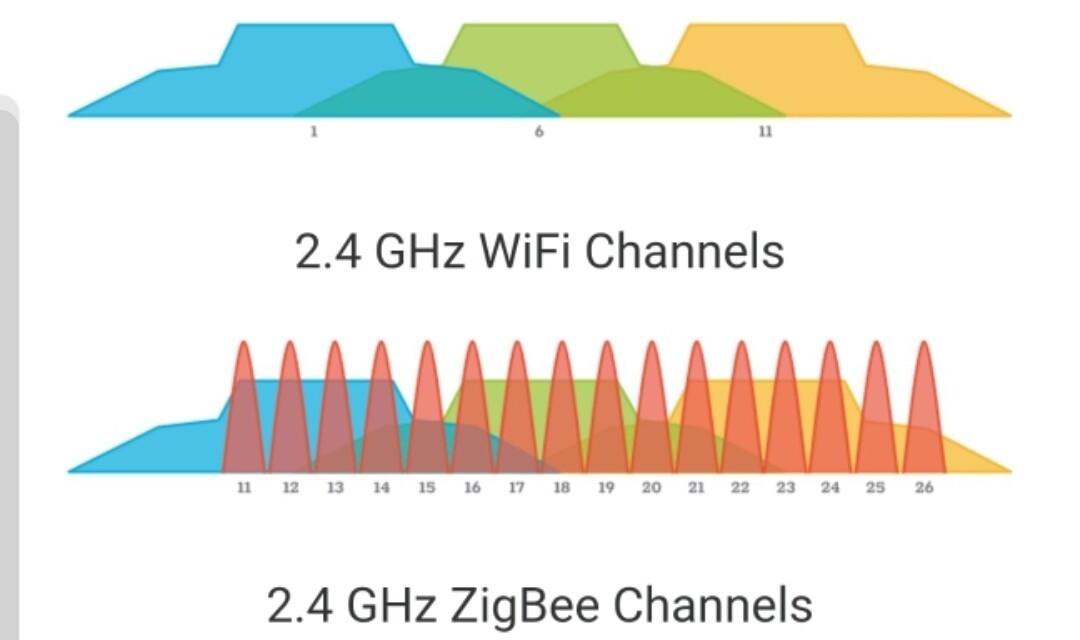

I’d check your WiFi channel on your router and if it is on channel 11 it may be creating noise and if closer to the switch misbehaving it could be the issue.
I’m guessing your appletv is using channel 25 as most seem to have that be the case. You can go in to the Nanoleaf app and click on thread network and then click on the name above first device and it will tell you the channel number.
Thread is channel 25, hue/zigbee is channel 20, and my 2.4ghz band is channel 6(auto) with a width of 5, which- I don’t know a lot about this, but when I clicked on history, I saw channel 11 pop up a few times. There are still a few devices on my 5ghz band, like Ring cameras and our Owlet baby monitor camera (which is literally between the switch and the bulbs.) the 5 ghz 1 band says channel 132. The 5 GHz 2 band says channel 36. I didn’t realize I had two and I’m not sure I use both.

Here is what Iwould do. Don’t worry about your 5ghz stuff. It is irrelevant.
Change your 2.4 off of auto and put down at channel 1. 20 for Zigbee is just inside Chanel 11 and 25 for thread is other end of channel 11. Channel 6 should be ok but you said you see 11 in history.
If your access point is roaming around to channel 11 it can affect both your Zigbee and thread network.
At least if you do this you can kind of rule out your WiFi as a potential issue to keep testing.
