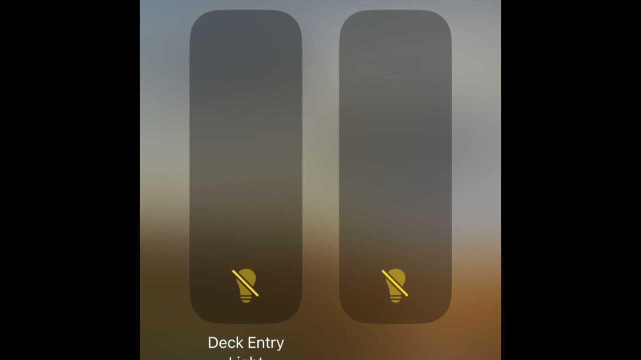

Has anyone figured out how to get consistent behavior of the LED bar with Siri commands.
I just received my order yesterday and got them installed today, and when using Siri voice commands, I get inconsistent behavior of what happens with the LED light bar.
For some of my switches, “Hey Siti, turn the Kitchen Table Light On” will turn on the load, but not the LED bar.
For some of my switches, “Hey Siri, turn the Deck Entry Light on” will turn on both the load and the LED bar.
For some of my switches, “Hey Siri, turn the dining room light on” will turn them both on, but not at the same time (probably HomeKit being weird).
“Turn on all the lights in the kitchen” will usually turn on both the load and the LED bar for all switches in the kitchen.
“Turn off all the lights in the kitchen” will likewise turn off both the load and the LED light bar for all switches in the kitchen.
See this quick video on YouTube:
I have consistently left the load named “Light” and the LED bar named “LED Bar”, as that’s the first setup I had success with.
It does not seem to matter if it’s in Dimmer or on/off mode. It does not seem to matter if I’m having them show up as one tile in HomeKit or not.
I can’t seem to move the LED bar to a different room without also moving the load.
My preferred behavior would be for the LED bar to never turn on with voice commands, but preserve the ability to use it in automations. It’d also be nice to get the LED bars to disappear from basically all the default views in the home app.
I’ll continue to play around, but very curious if anyone else already knows what to do so I don’t have to figure it out. Next thing I was going to play with was setting the default LED intensity when on to 0. It’d be nice if we had insight to the Apple black magic behavior so I can make it do something predictable without training my family.
Thanks in advance!

Yeah, this is unfortunately a limitation with Apple (and all other Matter hubs we’ve tested). With Zigbee/Z-Wave, when you set it to Smart Bulb Mode, and then use Zigbee Bindings or Z-Wave Associations, the LED Bar can track the light bulb intensity and will adjust accordingly. Matter has Bindings as well, but none of the hubs support it right now. Once they do, we can push an update that will allow the LED Bar to track the light level.
I think the only workaround at this point is to setup an automation that says, “if Smart Bulb = x%, then turn on LED Bar to x%”. In other words, you won’t be able to see in real time via the LED Bar what level the smart bulb is at, but once you get your smart bulb to the level you want, the LED Bar will follow via an automation. I can work on a help article for this.

Question for you – does the LED Bar turn on at the light switch itself (i.e., the UI does not turn on the LED Bar light, but the physical switch turns the LED Bar on)?
I’m guessing what’s happening is the LED Bar on your physical switch turns on blue (the default color), but it doesn’t turn on to whatever color you’ve set it to on the LED Bar on the right in the UI. Is that correct?
If so, then again, I want to apologize for not putting this in the initial instructions, but if what you’re trying to accomplish is to have the switch turn on and the LED Bar turn a color other than the default blue, then you have to set this behavior via local configuration.
So, for example, if you wanted to turn on your Kitchen Light via Siri and have the LED Bar turn White, you would do the following:
Here’s a GIF for reference:
A full list of the configuration options can be found here:
Let me know if that’s what you’re trying to accomplish and again, really sorry for all the confusion!
Edit: I have vacation brain on right now as I’m about to head out for vacation and I didn’t read what you were trying to accomplish. Let me see if I can help:
If you want the default blue to not turn on when the switch is on, what you can do is set the intensity level of the LED Bar to 0% when the light is on and off.
To do this, follow that link above that leads you to the Local Configuration Options and you’ll want to set the following parameters to 0:

Hey Eric. Thanks for the reply and your patience typing out detailed parameter and configuration changes that are sub-optimal on the home platform, and already referenced in your documentation. I do understand how to change the behavior in the switch per the parameters (I think, haven’t done it yet). This is about Apple Home behavior catching the LED bar as a “light” that is included in voice commands in an unpredictable way.
The physical switch sets the light bar per the parameters. This is voice control referencing the lights in a room or area.
No, this would be ideal, consistent, and expected based on what I understand the switch is doing. What’s happening instead is that voice commands control both the load and the light bar per whatever Siri would set it to, which by default is bright white and 100%.
So for example, if I say “hey siri, turn the dining room light on”, the behavior is as follows:
  1. The LED bar flashes white when it turns on (because Siri just set it to white @ 100%)
  2. The load starts to ramp up, and the LED bar turns blue and ramps with it
  3. When the load is done ramping, the LED bar goes back to bright white, and then stays that way until I turn it off with HomeKit or Siri. It’s more like a color notification than anything the switch is doing.
There’s another implication of this, which is related to automations. I have an automation to turn an LED bar to orange when the garage is open, and to green when the garage closes. That’s great. But if I then say “hey siri, turn off all the inside lights”, it turns off all the LED bars as well (until the next time a automation catches one).
The net net of this is that when I use voice commands, most of my switches are also glowing bright white at me when the load is on (vs the blue that you’d expect per the parameters you mention above.
