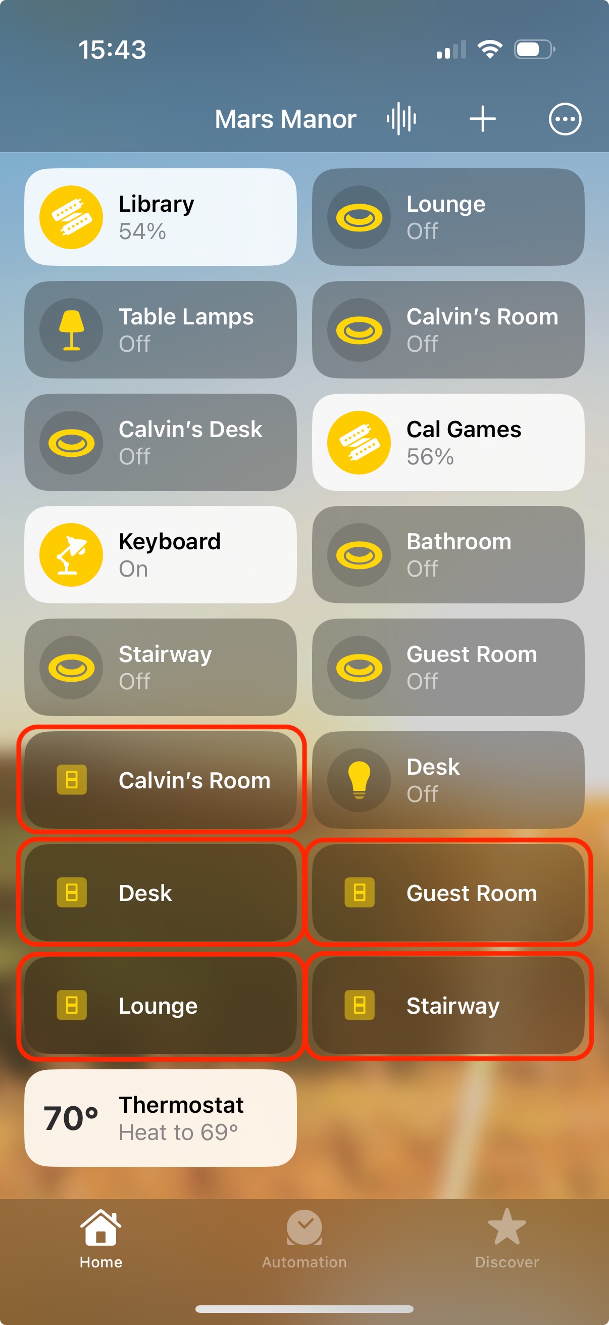

But I’ve experienced a new problem lately, wondering if you guys are seeing it too: The Programmable Switch tiles have recently populated in my Home View and I can’t hide them. They really clutter up the view. Has anybody figured out a work-around for this?
I have an older iPad running iOS 16.7.10 which doesn’t exhibit this behavior, so I’m thinking is a recent change on the Apple side.
hi Von! I have the exact same ‘problem’ with the ‘programable switch tile’ showing up on my Apple Home Screen. It only started happening as soon as iOS 18.2 released so it seems like an Apple issue. I even went to iOS 18.3 dev betas and the problem still exists there. I am waiting for it to get resolved by Apple. Thanks!
