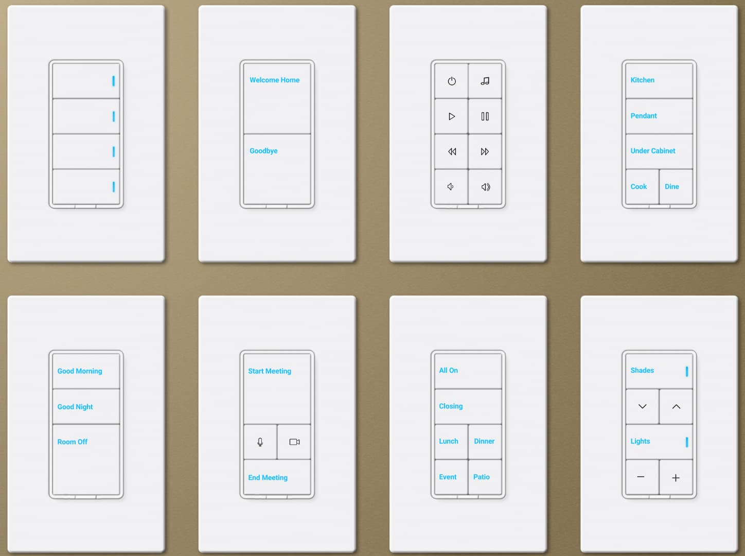

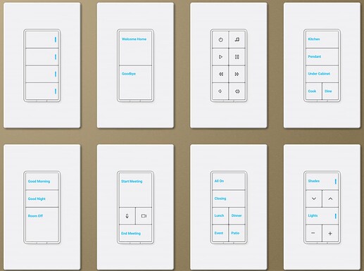

Has the design had to change from the original goal in order to make it work? The original design was very ambitious so I don’t necessarily mind if some things have been sacrificed but I’m curious where the design currently stands.
Hi there,
Here are some examples of what you can do with the button controller --we still have to update the videos on the site, but overall it looks pretty much the same:
The default (what comes in the box) is the switch at the top left.
We haven’t figured out what to put in the box yet in terms of other buttons, but here’s what will be available:
  • 2x2 button w/LED Indicator
  • 2x2 button w/out LED Indicator (used for backlight etching)
  • 1x2 button w/LED Indicator
  • 1x2 button w/out LED Indicator (used for backlight etching)
  • 1x2 button that looks like 2x 1x1 buttons w/LED Indicators on each button
  • 1x2 button that looks like 2x 1x1 butons w/out LED Indicators on each button (used for backlight etching)
There are no 2x1 buttons anymore as we could not get that design to work.
The reason we had to go with the, “fake” 1x1 buttons is because when we had individual buttons, the surface was inconsistent and not flush when the button was depressed and then let go of. In addition, there were inconsistent gaps between everything.
