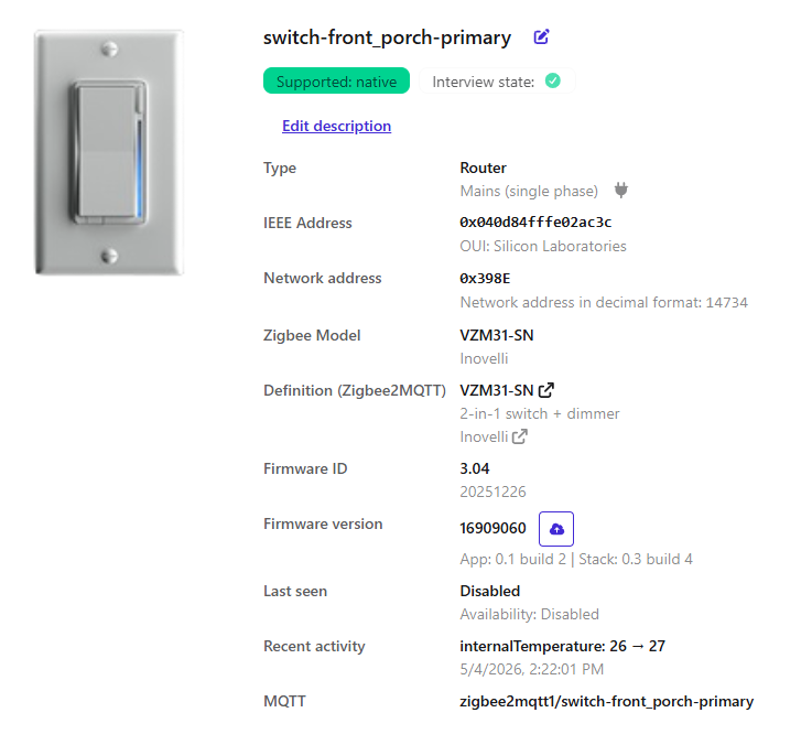

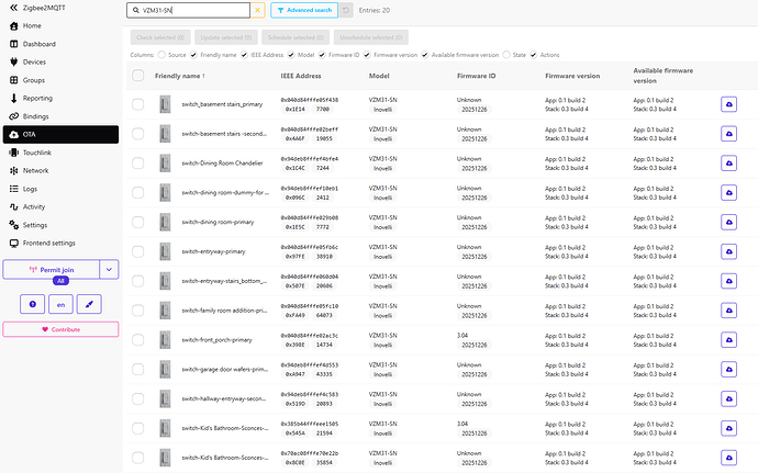

I’ve successfully now updated the firmware on my VZM31-SN Zigbee 2-1 Switches! All are now running 3.04, but only some of them come back and show V3.04. Reinterviewing/reconfiguring the ones that don’t automatically show 3.04 does not seem to help.
Removing, factory resetting via keypress, and re-pairing does not seem to fix it either.
It’s not stopping them from working, but some fields seem to throw errors, and clearly something isn’t quite right.

My feelings on the state of delivery for this firmware are well known elsewhere, and this is one more thing I needed to do on every single switch to get them to show the version:
In zigbee2mqtt, find the device, select dev console, choose read for the genBasic cluster and attribute swBuildId, it will read it from the switch.
Afterward it seems to stick. I don’t believe I had to do it again when I went from 3.04 to the 3.07 beta, which is what you should probably update to anyway since 3.04 is busted.
It’s not the firmware, it’s a recent bug in Z2M that we just fixed: fix: Preserve genBasic attributes when re-read returns undefined by rohankapoorcom · Pull Request #1753 · Koenkk/zigbee-herdsman · GitHub
It should be available in the dev / edge build in a couple of days, otherwise there’s a custom docker image linked from the PR comments.
