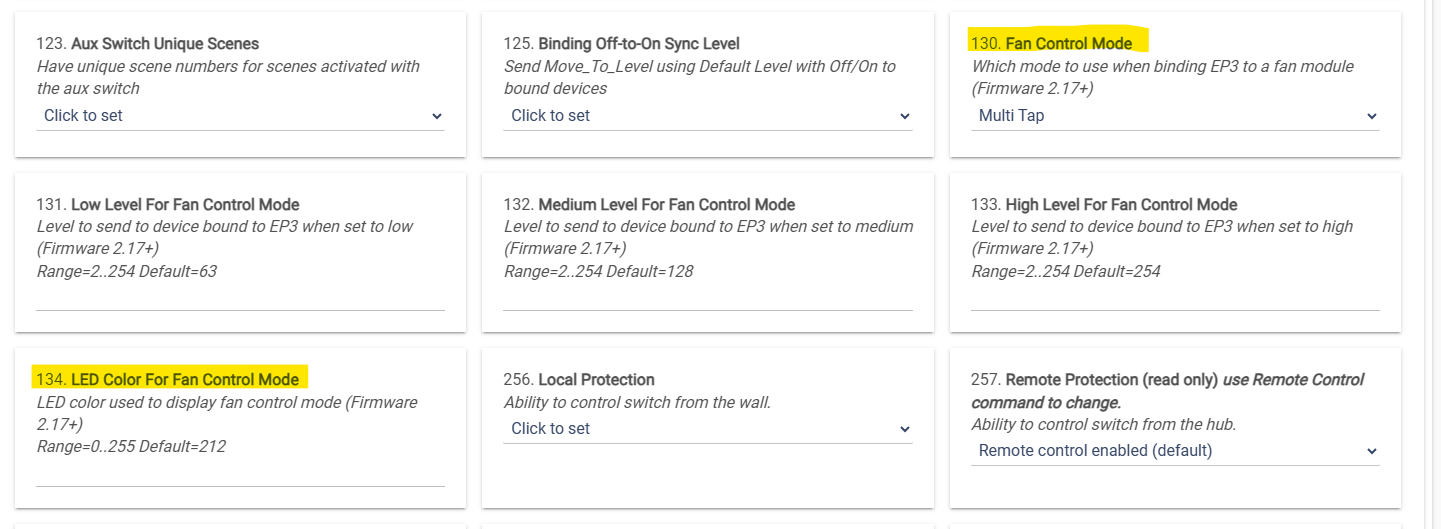

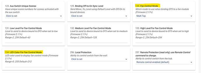

The latest Hubitat driver should have these options. Sometimes a factory reset may be necessary after the firmware update. I would set the following settings and if you still aren’t getting the led to change white then try the factory reset.
@offtohavasu or anyone else. If you would like to try firmware 2.17 for the bindings and are on Z2M or ZHA please send me a PM.
Sorry Eric, I don’t have a switch to test with (yet). But I’ll download the new driver for the canopy in Hubitat.
Thanks to Eric for helping me get the blue switch/dimmer bindings working with the blue canopy via hubitat. The new driver works great! With the proper bindings configured, paddle controls lights and config cycles the fans as-is my pref.
