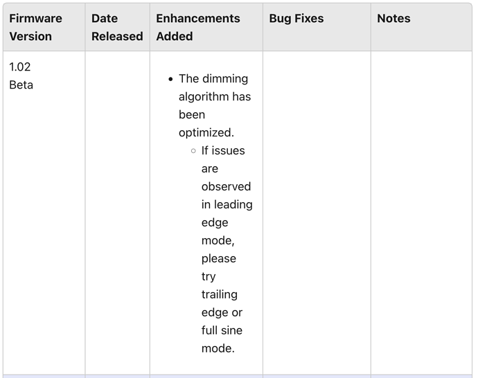

Been a while since I’ve checked back here. Does anyone know when beta 1.02 was released? I’m curious to try it because dimming was always iffy for me at low levels (with neutral). Also… how do you switch to beta firmware and is it easy to roll back?
